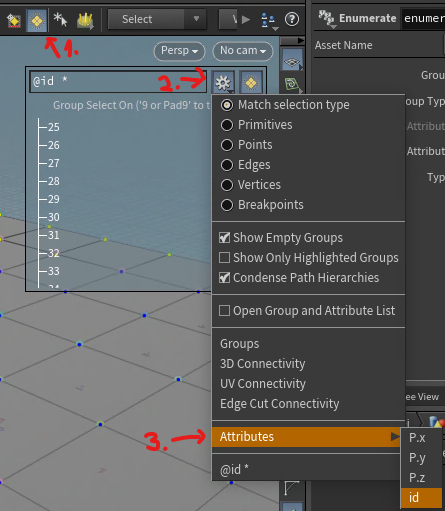

in Viewport Select state, press 9 to turn on Select Group mode, then Gear menu and pick Attributes/Id
then select some points in the viewport, press Enter and it will fill your Group parm with @id=1,22,33 etc..
same for any int or string attribute like @name, @path, ...
Screenshot 2026-07-29 094809.png (161.0 KB)
