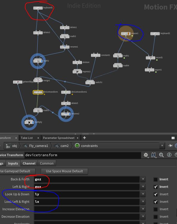

I made a project with chops for fly mode but there are a lot of problem to make it ideal. I cant get an up vector for rotation and make looking around by mouse more useful, change gamepad data to interactive values instead of always increasing
Press Scroll Lock to activate hotkeys WASD and toggle “1” hotkey to mouse look around
https://drive.google.com/file/d/1qA_xkXqVetHEM2aIR7ZwssxswYUh5wCI/view?usp=sharing [drive.google.com]
Joined: 9月 2014
so, I made it, almost what I need, if somebody interested in or want to try, welcome! and any comments and changes welcome too)
Fly Camera
https://drive.google.com/open?id=1NsoI_5LCUGwXKkNW8Zf6_OWkIJcldrZH [drive.google.com]
its an asset camera, help and instruction inside right on asset

As twod said a few posts up, from the main edit menu, Edit -> Intercept mode.
