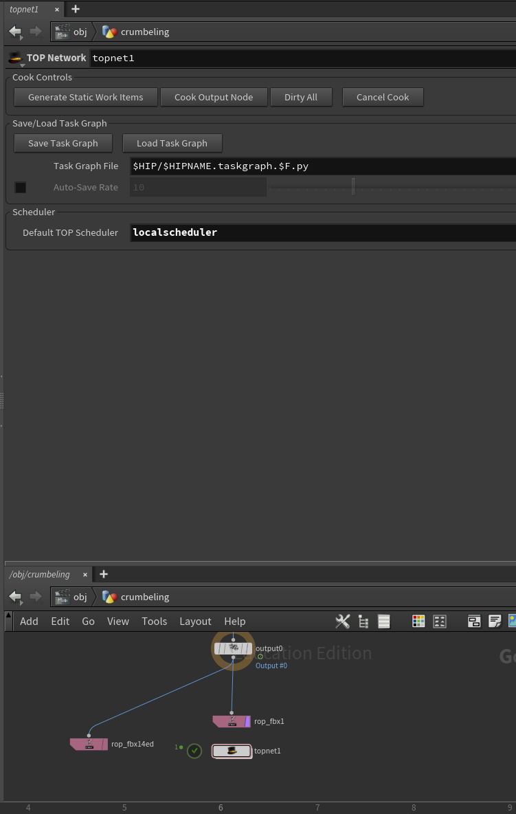

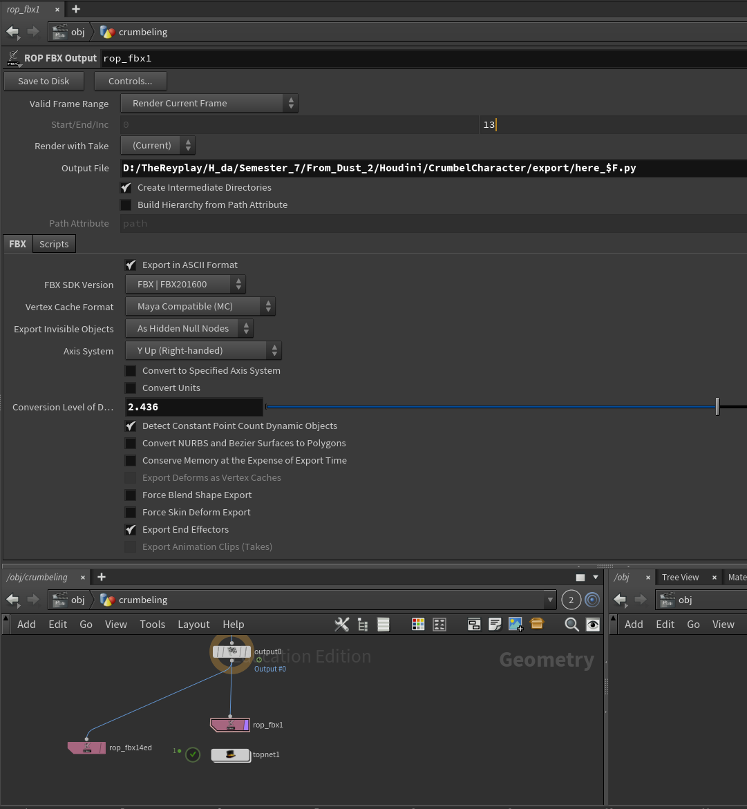

6 posts
Joined: 8月 2019
Hello,
Mine is not working and I am not sure why ...
If I click on save to disk on the Rop_fbx node I get just one frame exported as fbx
Edited by TheReyplay - 2022年1月21日 14:31:20
