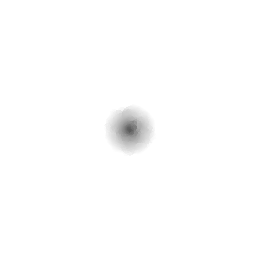

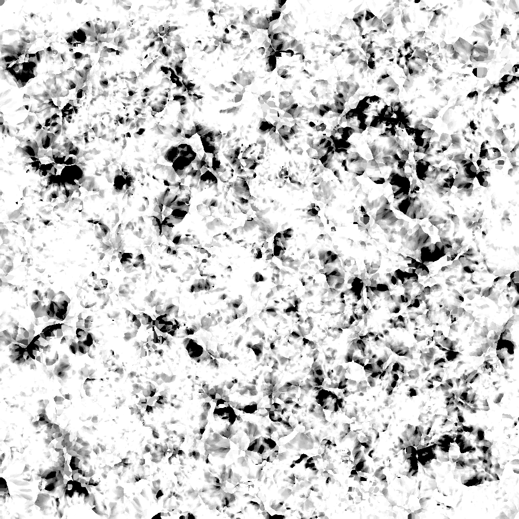

I'm trying to bake maps for a very simple noise grid with the new gameDev ‘maps baker’ node but I'm getting weird results, as shown in the images.
The low poly version of the noise grid is just the starting plain grid.
Could you tell me what's going on?
Cheers
first image: high poly geo
second: baked AO
third: baked height.
(ps. I'm not having issues at all with ‘simple baker’)
Cheers
second: baked AO

This seems to be a bug that slipped in. I have fixed & submitted the height issue. (Will be in build of tomorrow. 1.170)
I am also currently adjusting the AO calculation code, which should be in the build on Friday.
PS: When baking meshes that differ a lot (Any top down bakes / non-decimation meshes), you should use the Trace Mode set to Surface Normal.

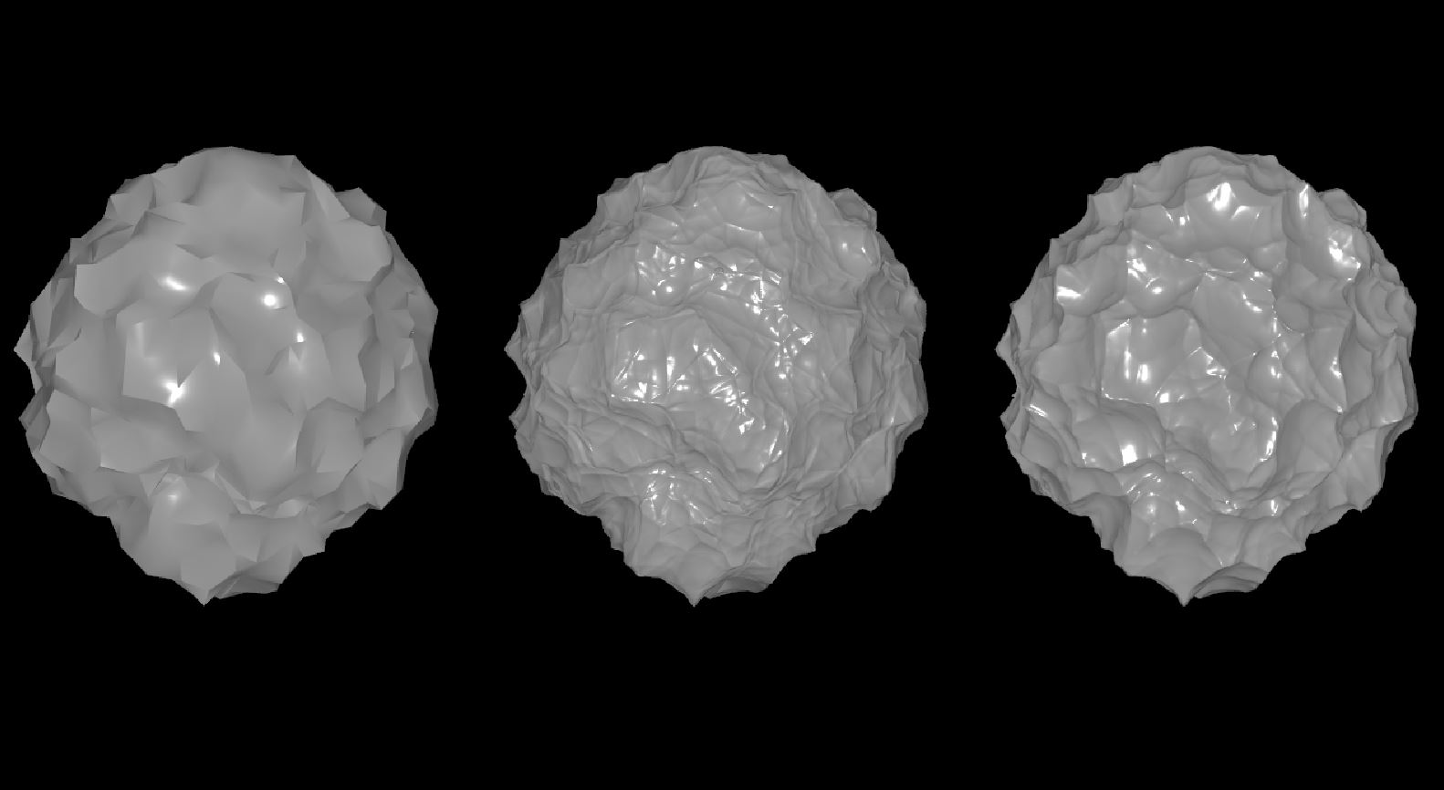

- I'm not able to match the high poly geo when I apply the heightmap generated by the ‘maps baker’. In the second picture, from left to right: low-poly with no displace, low poly displaced, high poly geo.
I tried baking with both Surface Normal and Nearest Surface methods, with not good results.
Last two points are probably due to my inexperience with this baking workflow and I'm seeking advice to fix them.
