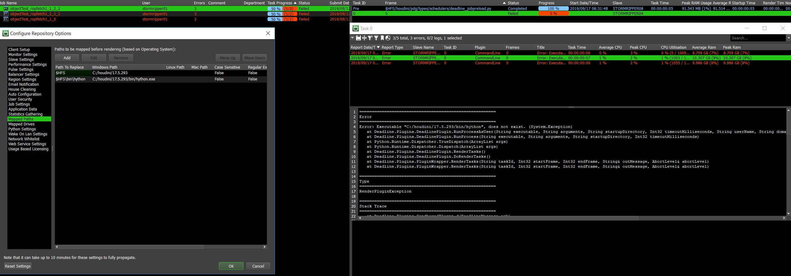

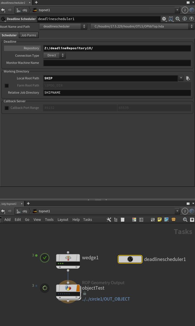

Hi @Seelan,
I was wondering if you could assist me in making the Deadline Scheduler in TOPs work with Deadline.
In my pipeline we're currently using Houdini 17.5.229, we haven't been able to update to a new version such as the 17.5.362 build you suggested recently.
I got the submission of a simple wedge job (3 wedges) working and I see the jobs showing up in my Deadline Monitor, however the 3 tasks for each wedge respectively are being displayed as Command Line tasks and never kick off, nor do they show an error.
For the same reason I can't look at any logs or error reports since the jobs never launch on a deadline slave.
Does anything stand out to you as incorrect to you in my attached screenshots? Do you have any pointers for me on what I could do to get this to function properly?

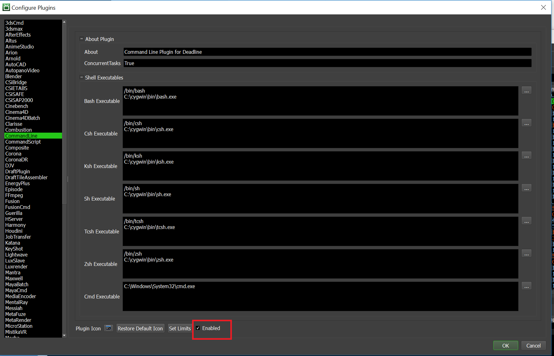

You are using the old Deadline scheduler, so there are a few setup things you have to do (which you don't need to do with the new one in 17.5.362).
If the jobs are not being picked up, most likely you'll need to enable CommandLine plugin in Deadline Monitor's Configure Plugins. See attach screenshot.

Hi Seelan,
Thanks for the support. Hopefully we can update to the latest built soon, we have to wait for Redshift to be compiled for it.
By enabling the CommandLine plugin, I got the “deadline_jobpreload.py” tasks to run and complete, however now I'm getting an error for the tasks that follows after:
Error: Executable “C:\houdini\17.5.293/bin/hython”, does not exist. (System.Exception)According to the following thread, I added the mapping for hython.exe, but I'm still getting the error.

You might need to restart your slave instances for the env mapping to take effect. If it did get picked up, it should have the .exe at the end. If restarting doesn't help, change the Windows Path in the mapping and see if the error message changes (just to make sure the env mapping is being taken into account).

Hi Seelan,
Thanks for the quick reply. Turns out the mapping for “$HFS/bin/hython.exe” wasn't taken into account, it was overridden from the Deadline Scheduler TOP itself. Once I fixed it there the error from above disappeared.
I attached a screenshot for the fix to this post.
I feel like I'm making progress, however now I'm running into another error.

Hi Seelan,
The “DEADLINE_PATH” env variable is indeed set to “C:\Program Files\Thinkbox\Deadline10\bin”.
I installed 17.5.383 and checked “Verbose Logging” on the Deadline Scheduler in TOPs.
Here's the output I'm getting:
Thanks for working with me on this!
Cheers,
M

The line to look out for is the following:
Error: could not find job info file: RunCommandForRepositoryDirectZ
deadlineRepository10 (Deadline.Submission.DeadlineSubmissionException)

If you only have a single Deadline repository, and its setup as the default one on your system, then could you try disabling the override on the Repository Path (and blanking out the path itself). The Repository Path is located in the TOP Deadline scheduler's parm under the Advanced section. Usually you don't need to set this if your are just using your default repository. See screenshot.
I am assuming that this was enabled or set when you updated from a saved hip file that was using the old scheduler, which did require the repository.
If on the other hand, you do need to specify a specific repository, there is a bug with that particular feature. I'll fix it for tomorrow's build.

Hi Seelan,
I need to set the Repository under the advanced tab, because it's located on one of our network drives.
When I submitted the job today of which I posted the log earlier, I actually deleted the Deadline Scheduler TOP and rebuilt it to make sure everything is brand new.
Just as a test, I removed the Repository checkbox as you suggested (also removed the path, just in case), I'm still getting an error:

From your log, it looks like its still using the override though:
Error: could not find job info file: RunCommandForRepositoryDirectZ:/deadlineRepository10 (Deadline.Submission.DeadlineSubmissionException)
Make sure you save the hip file after making the override disable change.
Even if the repository is located on a network drive, if your Deadline installation is setup to use it as the default, and the network drive doesn't change, then it should just work with the blank. You can test by opening up Deadline Monitor and setting the repository there.

So I made some progress.
You're right, the repository was already set in the deadline monitor, so I don't need to set it specifically in the Deadline Scheduler.
Here are some observations:
- If I right click on a ROP Geometry Output TOP and select “Dirty and Cook Output Node”, it sends a job to the farm and successfully executes it, so far so good.
- In the documentation of the “Tasks Menu” there's a “Dirty All” option which I can find in when right-clicking on a TOP node.
Currently the only way to recook everything (when making changes to let's say the SOP graph) is to click on “Delete Selected Node Results From Disk” and then click again on “Dirty and cook selected Node”. Is that the correct workflow or am I missing something?
Here's where it breaks again:
- when I click on “Submit Graph as Job” on the Deadline Scheduler. In this case I'm trying to cache 3 simple wedges, but rather then showing me 3 job items under 1 task in Deadline, I see 2 tasks, that hold 1 job item each. The first task never completes due to an error. Here's the log:
Thanks for your help.

2019-09-20 10:22:07: 0: Loading Job's Plugin timeout is Disabled
2019-09-20 10:22:09: 0: Executing plugin command of type ‘Sync Files for Job’
2019-09-20 10:22:09: 0: All job files are already synchronized
2019-09-20 10:22:09: 0: Synchronizing Plugin PDGDeadline from P:/stormborn/tst/wow/wow_0050/houdini/pdgtemp/17368/plugins\PDGDeadline took: 0 seconds
2019-09-20 10:22:09: 0: Done executing plugin command of type ‘Sync Files for Job’
2019-09-20 10:22:09: 0: Executing plugin command of type ‘Initialize Plugin’
2019-09-20 10:22:10: 0: INFO: Executing plugin script ‘C:\Users\Stormripper01\AppData\Local\Thinkbox\Deadline10\slave\stormripper01\plugins\5d850ab729c0291404883070\PDGDeadline.py’
2019-09-20 10:22:10: 0: INFO: *********** PDGDeadline InitializeProcess
2019-09-20 10:22:10: 0: INFO: About: PDG Plugin for Deadline
2019-09-20 10:22:10: 0: INFO: Render Job As User disabled, running as current user ‘Stormripper01’
2019-09-20 10:22:10: 0: INFO: The job's environment will be merged with the current environment before rendering
2019-09-20 10:22:10: 0: Done executing plugin command of type ‘Initialize Plugin’
2019-09-20 10:22:10: 0: Start Job timeout is disabled.
2019-09-20 10:22:10: 0: Task timeout is disabled.
2019-09-20 10:22:10: 0: Loaded job: PDG tst_wow_0050_wrk_pdgDeadlineTest_v001 (5d850ab729c0291404883070)
2019-09-20 10:22:10: 0: Executing plugin command of type ‘Start Job’
2019-09-20 10:22:10: 0: INFO: Executing global job preload script ‘C:\Users\Stormripper01\AppData\Local\Thinkbox\Deadline10\slave\stormripper01\plugins\5d850ab729c0291404883070\GlobalJobPreLoad.py’
2019-09-20 10:22:10: 0: INFO: Looking for AWS Portal File Transfer…
2019-09-20 10:22:10: 0: INFO: Looking for File Transfer controller in C:/Program Files/Thinkbox/S3BackedCache/bin/task.py…
2019-09-20 10:22:10: 0: INFO: Could not find AWS Portal File Transfer.
2019-09-20 10:22:10: 0: INFO: AWS Portal File Transfer is not installed on the system.
2019-09-20 10:22:10: 0: Done executing plugin command of type ‘Start Job’
2019-09-20 10:22:10: 0: Plugin rendering frame(s): 0
2019-09-20 10:22:10: 0: Executing plugin command of type ‘Render Task’
2019-09-20 10:22:10: 0: INFO: StartFrame: 0
2019-09-20 10:22:10: 0: INFO: Startup Directory: P:/stormborn/tst/wow/wow_0050/houdini/pdgtemp/17368
2019-09-20 10:22:10: 0: INFO: Looking for task file: P:/stormborn/tst/wow/wow_0050/houdini/pdgtemp/17368/job_e1e4e6bf40ba4632a7c882254ea3a158\task_0.txt
2019-09-20 10:22:10: 0: INFO: Setting PATH: C:\Program Files\Thinkbox\Deadline10\bin\;C:\Program Files (x86)\Common Files\Oracle\Java\javapath;C:\WINDOWS\system32;C:\WINDOWS;C:\WINDOWS\System32\Wbem;C:\WINDOWS\System32\WindowsPowerShell\v1.0\;C:\Python27;C:\python27\lib\site-packages;C:\Python27\Scripts;C:\Program Files\MongoDB\Server\3.4\bin;C:\Program Files\Sublime Text 3;C:\Program Files\Git\cmd;C:\WINDOWS\System32\OpenSSH\;C:\Program Files (x86)\QuickTime\QTSystem\;C:\Program Files (x86)\NVIDIA Corporation\PhysX\Common;C:\Users\Stormripper01\AppData\Local\Microsoft\WindowsApps;C:\Users\Stormripper01\AppData\Local\GitHubDesktop\bin;%USERPROFILE%\AppData\Local\Microsoft\WindowsApps;;C:/houdini/17.5.384/bin
2019-09-20 10:22:10: 0: INFO: $HYTHON mapped to: C:/houdini/17.5.384/bin/hython.exe
2019-09-20 10:22:10: 0: INFO: Task Executable: C:/houdini/17.5.384/bin/hython.exe
2019-09-20 10:22:10: 0: INFO: Task Arguments: P:/stormborn/tst/wow/wow_0050/houdini/pdgtemp/17368/scripts/top.py –report none –hip P:/stormborn/tst/wow/wow_0050/houdini/tst_wow_0050_wrk_pdgDeadlineTest_v001.hip –toppath /obj/topnet1
2019-09-20 10:22:10: 0: INFO: Invoking: Run Process
2019-09-20 10:22:16: 0: STDOUT: Running Houdini 17.5.384
2019-09-20 10:22:17: 0: STDOUT: Loading .hip file P:/stormborn/tst/wow/wow_0050/houdini/tst_wow_0050_wrk_pdgDeadlineTest_v001.hip.
2019-09-20 10:22:20: 0: STDOUT: Given Node ‘topnet1’, Cooking Node ‘objectTest’
2019-09-20 10:25:56: Scheduler Thread - Task “0_0-0” could not be found because job with ID 5d850ab729c0291404883070 does not exist
2019-09-20 10:25:56: Scheduler Thread - Cancelling task…
2019-09-20 10:25:56: 0: Executing plugin command of type ‘Cancel Task’
2019-09-20 10:25:56: 0: Done executing plugin command of type ‘Cancel Task’
2019-09-20 10:25:56: 0: Done executing plugin command of type ‘Render Task’
2019-09-20 10:25:56: 0: In the process of canceling current task: ignoring exception thrown by PluginLoader
2019-09-20 10:25:56: 0: Executing plugin command of type ‘End Job’
2019-09-20 10:25:56: 0: Done executing plugin command of type ‘End Job’
2019-09-20 10:25:57: Scheduler Thread - In the process of canceling current tasks: ignoring exception thrown by render thread 0
2019-09-20 10:25:59: Skipping pending job scan because it is not required at this time
2019-09-20 10:25:59: Skipping repository repair because it is not required at this time
2019-09-20 10:25:59: Skipping house cleaning because it is not required at this time
2019-09-20 10:26:09: 0: Loading Job's Plugin timeout is Disabled
2019-09-20 10:26:10: 0: Executing plugin command of type ‘Sync Files for Job’
2019-09-20 10:26:10: 0: All job files are already synchronized
2019-09-20 10:26:10: 0: Synchronizing Plugin PDGDeadline from P:/stormborn/tst/wow/wow_0050/houdini/pdgtemp/17368/plugins\PDGDeadline took: 0 seconds
2019-09-20 10:26:10: 0: Done executing plugin command of type ‘Sync Files for Job’
2019-09-20 10:26:10: 0: Executing plugin command of type ‘Initialize Plugin’
2019-09-20 10:26:11: 0: INFO: Executing plugin script ‘C:\Users\Stormripper01\AppData\Local\Thinkbox\Deadline10\slave\stormripper01\plugins\5d850baa29c0291100d62d86\PDGDeadline.py’
2019-09-20 10:26:11: 0: INFO: *********** PDGDeadline InitializeProcess
2019-09-20 10:26:11: 0: INFO: About: PDG Plugin for Deadline
2019-09-20 10:26:11: 0: INFO: Render Job As User disabled, running as current user ‘Stormripper01’
2019-09-20 10:26:11: 0: INFO: The job's environment will be merged with the current environment before rendering
2019-09-20 10:26:11: 0: Done executing plugin command of type ‘Initialize Plugin’
2019-09-20 10:26:11: 0: Start Job timeout is disabled.
2019-09-20 10:26:11: 0: Task timeout is disabled.
2019-09-20 10:26:11: 0: Loaded job: PDG tst_wow_0050_wrk_pdgDeadlineTest_v001 (5d850baa29c0291100d62d86)
2019-09-20 10:26:11: 0: Executing plugin command of type ‘Start Job’
2019-09-20 10:26:11: 0: INFO: Executing global job preload script ‘C:\Users\Stormripper01\AppData\Local\Thinkbox\Deadline10\slave\stormripper01\plugins\5d850baa29c0291100d62d86\GlobalJobPreLoad.py’
2019-09-20 10:26:11: 0: INFO: Looking for AWS Portal File Transfer…
2019-09-20 10:26:11: 0: INFO: Looking for File Transfer controller in C:/Program Files/Thinkbox/S3BackedCache/bin/task.py…
2019-09-20 10:26:11: 0: INFO: Could not find AWS Portal File Transfer.
2019-09-20 10:26:11: 0: INFO: AWS Portal File Transfer is not installed on the system.
2019-09-20 10:26:11: 0: Done executing plugin command of type ‘Start Job’
2019-09-20 10:26:11: 0: Plugin rendering frame(s): 0
2019-09-20 10:26:12: 0: Executing plugin command of type ‘Render Task’
2019-09-20 10:26:12: 0: INFO: StartFrame: 0
2019-09-20 10:26:12: 0: INFO: Startup Directory: P:/stormborn/tst/wow/wow_0050/houdini/pdgtemp/17368
2019-09-20 10:26:12: 0: INFO: Looking for task file: P:/stormborn/tst/wow/wow_0050/houdini/pdgtemp/17368/job_144ea87c4927459b80c0fe8e364ba348\task_0.txt
2019-09-20 10:26:12: 0: INFO: Starting monitor program: python.exe P:/stormborn/tst/wow/wow_0050/houdini/pdgtemp/17368/scripts/pdgmq.py –xmlport 0 –relayport 0 –connectionfile P:/stormborn/tst/wow/wow_0050/houdini/pdgtemp/17368/job_144ea87c4927459b80c0fe8e364ba348/pdgmq_server.txt –start
2019-09-20 10:26:12: 0: INFO: File “python.exe” is not rooted, checking current directory
2019-09-20 10:26:12: 0: INFO: File “python.exe” is not rooted and is not in the current directory, checking PATH
2019-09-20 10:26:12: 0: INFO: Starting monitored program: PDGMonitor
2019-09-20 10:26:12: 0: INFO: Program executable: C:\Python27\python.exe
2019-09-20 10:26:12: 0: INFO: Program arguments: P:/stormborn/tst/wow/wow_0050/houdini/pdgtemp/17368/scripts/pdgmq.py –xmlport 0 –relayport 0 –connectionfile P:/stormborn/tst/wow/wow_0050/houdini/pdgtemp/17368/job_144ea87c4927459b80c0fe8e364ba348/pdgmq_server.txt –start
2019-09-20 10:26:12: 0: PDG_MQ STORMRIPPER01 60534 60535
2019-09-20 10:26:12: 0: ## Message Queue Server Running
2019-09-20 10:26:12: 0: INFO: Got MQ server info: PDG_MQ STORMRIPPER01 60534 60535
2019-09-20 10:26:12: 0: INFO: Setting PATH: C:\Program Files\Thinkbox\Deadline10\bin\;C:\Program Files (x86)\Common Files\Oracle\Java\javapath;C:\WINDOWS\system32;C:\WINDOWS;C:\WINDOWS\System32\Wbem;C:\WINDOWS\System32\WindowsPowerShell\v1.0\;C:\Python27;C:\python27\lib\site-packages;C:\Python27\Scripts;C:\Program Files\MongoDB\Server\3.4\bin;C:\Program Files\Sublime Text 3;C:\Program Files\Git\cmd;C:\WINDOWS\System32\OpenSSH\;C:\Program Files (x86)\QuickTime\QTSystem\;C:\Program Files (x86)\NVIDIA Corporation\PhysX\Common;C:\Users\Stormripper01\AppData\Local\Microsoft\WindowsApps;C:\Users\Stormripper01\AppData\Local\GitHubDesktop\bin;%USERPROFILE%\AppData\Local\Microsoft\WindowsApps;;C:/houdini/17.5.384/bin
2019-09-20 10:26:12: 0: INFO: $HYTHON mapped to: C:/houdini/17.5.384/bin/hython.exe
2019-09-20 10:26:12: 0: INFO: Task Executable: C:/houdini/17.5.384/bin/hython.exe
2019-09-20 10:26:12: 0: INFO: Task Arguments: P:/stormborn/tst/wow/wow_0050/houdini/pdgtemp/17368/scripts/rop.py -p P:/stormborn/tst/wow/wow_0050/houdini/tst_wow_0050_wrk_pdgDeadlineTest_v001.hip -n /obj/topnet1/objectTest/ropnet1/geometry1 -to /obj/topnet1/objectTest -i objectTest_ropfetch1_1_19 -fs 1 -fe 1 -fi 1
2019-09-20 10:26:12: 0: INFO: Invoking: Run Process
2019-09-20 10:26:13: 0: ## Connection from ('192.168.100.10', 60537)
2019-09-20 10:26:13: 0: ## Relay Mode Active
2019-09-20 10:26:19: 0: STDOUT: Loading .hip file P:/stormborn/tst/wow/wow_0050/houdini/tst_wow_0050_wrk_pdgDeadlineTest_v001.hip.
2019-09-20 10:26:22: 0: 0.0 mps, avg=0.0ms, max=0.0ms
2019-09-20 10:26:23: 0: STDOUT: PDG_RESULT: objectTest_ropfetch1_1_19;-1;'__PDG_DIR__/cache/object_2/objectTest_2.1.bgeo.sc';;0
2019-09-20 10:26:23: 0: Done executing plugin command of type ‘Render Task’
2019-09-20 10:26:27: 0: Start Job timeout is disabled.
2019-09-20 10:26:27: 0: Task timeout is disabled.
2019-09-20 10:26:27: 0: Plugin rendering frame(s): 1
2019-09-20 10:26:28: 0: Executing plugin command of type ‘Render Task’
2019-09-20 10:26:28: 0: INFO: StartFrame: 1
2019-09-20 10:26:28: 0: INFO: Startup Directory: P:/stormborn/tst/wow/wow_0050/houdini/pdgtemp/17368
2019-09-20 10:26:28: 0: INFO: Looking for task file: P:/stormborn/tst/wow/wow_0050/houdini/pdgtemp/17368/job_144ea87c4927459b80c0fe8e364ba348\task_1.txt
2019-09-20 10:26:28: 0: INFO: Setting PATH: C:\Program Files\Thinkbox\Deadline10\bin\;C:\Program Files (x86)\Common Files\Oracle\Java\javapath;C:\WINDOWS\system32;C:\WINDOWS;C:\WINDOWS\System32\Wbem;C:\WINDOWS\System32\WindowsPowerShell\v1.0\;C:\Python27;C:\python27\lib\site-packages;C:\Python27\Scripts;C:\Program Files\MongoDB\Server\3.4\bin;C:\Program Files\Sublime Text 3;C:\Program Files\Git\cmd;C:\WINDOWS\System32\OpenSSH\;C:\Program Files (x86)\QuickTime\QTSystem\;C:\Program Files (x86)\NVIDIA Corporation\PhysX\Common;C:\Users\Stormripper01\AppData\Local\Microsoft\WindowsApps;C:\Users\Stormripper01\AppData\Local\GitHubDesktop\bin;%USERPROFILE%\AppData\Local\Microsoft\WindowsApps;;C:/houdini/17.5.384/bin
2019-09-20 10:26:28: 0: INFO: $HYTHON mapped to: C:/houdini/17.5.384/bin/hython.exe
2019-09-20 10:26:28: 0: INFO: Task Executable: C:/houdini/17.5.384/bin/hython.exe
2019-09-20 10:26:28: 0: INFO: Task Arguments: P:/stormborn/tst/wow/wow_0050/houdini/pdgtemp/17368/scripts/rop.py -p P:/stormborn/tst/wow/wow_0050/houdini/tst_wow_0050_wrk_pdgDeadlineTest_v001.hip -n /obj/topnet1/objectTest/ropnet1/geometry1 -to /obj/topnet1/objectTest -i objectTest_ropfetch1_1_18 -fs 1 -fe 1 -fi 1
2019-09-20 10:26:28: 0: INFO: Invoking: Run Process
2019-09-20 10:26:32: 0: 0.1 mps, avg=1.9ms, max=1.9ms
2019-09-20 10:26:35: 0: STDOUT: Loading .hip file P:/stormborn/tst/wow/wow_0050/houdini/tst_wow_0050_wrk_pdgDeadlineTest_v001.hip.
2019-09-20 10:26:39: 0: STDOUT: PDG_RESULT: objectTest_ropfetch1_1_18;-1;'__PDG_DIR__/cache/object_1/objectTest_1.1.bgeo.sc';;0
2019-09-20 10:26:39: 0: Done executing plugin command of type ‘Render Task’
2019-09-20 10:26:42: 0: 0.1 mps, avg=2.6ms, max=2.6ms
2019-09-20 10:26:43: 0: Start Job timeout is disabled.
2019-09-20 10:26:43: 0: Task timeout is disabled.
2019-09-20 10:26:43: 0: Plugin rendering frame(s): 2
2019-09-20 10:26:44: 0: Executing plugin command of type ‘Render Task’
2019-09-20 10:26:44: 0: INFO: StartFrame: 2
2019-09-20 10:26:44: 0: INFO: Startup Directory: P:/stormborn/tst/wow/wow_0050/houdini/pdgtemp/17368
2019-09-20 10:26:44: 0: INFO: Looking for task file: P:/stormborn/tst/wow/wow_0050/houdini/pdgtemp/17368/job_144ea87c4927459b80c0fe8e364ba348\task_2.txt
2019-09-20 10:26:44: 0: INFO: Setting PATH: C:\Program Files\Thinkbox\Deadline10\bin\;C:\Program Files (x86)\Common Files\Oracle\Java\javapath;C:\WINDOWS\system32;C:\WINDOWS;C:\WINDOWS\System32\Wbem;C:\WINDOWS\System32\WindowsPowerShell\v1.0\;C:\Python27;C:\python27\lib\site-packages;C:\Python27\Scripts;C:\Program Files\MongoDB\Server\3.4\bin;C:\Program Files\Sublime Text 3;C:\Program Files\Git\cmd;C:\WINDOWS\System32\OpenSSH\;C:\Program Files (x86)\QuickTime\QTSystem\;C:\Program Files (x86)\NVIDIA Corporation\PhysX\Common;C:\Users\Stormripper01\AppData\Local\Microsoft\WindowsApps;C:\Users\Stormripper01\AppData\Local\GitHubDesktop\bin;%USERPROFILE%\AppData\Local\Microsoft\WindowsApps;;C:/houdini/17.5.384/bin
2019-09-20 10:26:44: 0: INFO: $HYTHON mapped to: C:/houdini/17.5.384/bin/hython.exe
2019-09-20 10:26:44: 0: INFO: Task Executable: C:/houdini/17.5.384/bin/hython.exe
2019-09-20 10:26:44: 0: INFO: Task Arguments: P:/stormborn/tst/wow/wow_0050/houdini/pdgtemp/17368/scripts/rop.py -p P:/stormborn/tst/wow/wow_0050/houdini/tst_wow_0050_wrk_pdgDeadlineTest_v001.hip -n /obj/topnet1/objectTest/ropnet1/geometry1 -to /obj/topnet1/objectTest -i objectTest_ropfetch1_1_17 -fs 1 -fe 1 -fi 1
2019-09-20 10:26:44: 0: INFO: Invoking: Run Process
2019-09-20 10:26:50: 0: STDOUT: Loading .hip file P:/stormborn/tst/wow/wow_0050/houdini/tst_wow_0050_wrk_pdgDeadlineTest_v001.hip.
2019-09-20 10:26:52: 0: 0.0 mps, avg=0.0ms, max=0.0ms
2019-09-20 10:26:54: 0: STDOUT: PDG_RESULT: objectTest_ropfetch1_1_17;-1;'__PDG_DIR__/cache/object_0/objectTest_0.1.bgeo.sc';;0
2019-09-20 10:26:54: 0: Done executing plugin command of type ‘Render Task’
2019-09-20 10:26:55: INFO: STORMBORN PDG tst_wow_0050_wrk_pdgDeadlineTest_v001 job finished. Attempting db add
2019-09-20 10:26:55: INFO: STORMBORN job frames: 0-2
2019-09-20 10:26:55: INFO: STORMBORN job isWedge: False
2019-09-20 10:26:55: INFO: STORMBORN job wedgeNumber: -1
2019-09-20 10:26:55: INFO: STORMBORN job sceneFile:
2019-09-20 10:26:55: INFO: STORMBORN JobPluginInfoKey EXCEPT: local variable ‘ext’ referenced before assignment
2019-09-20 10:26:55: INFO: STORMBORN job 5d850baa29c0291100d62d86 finished. status: “Completed”
