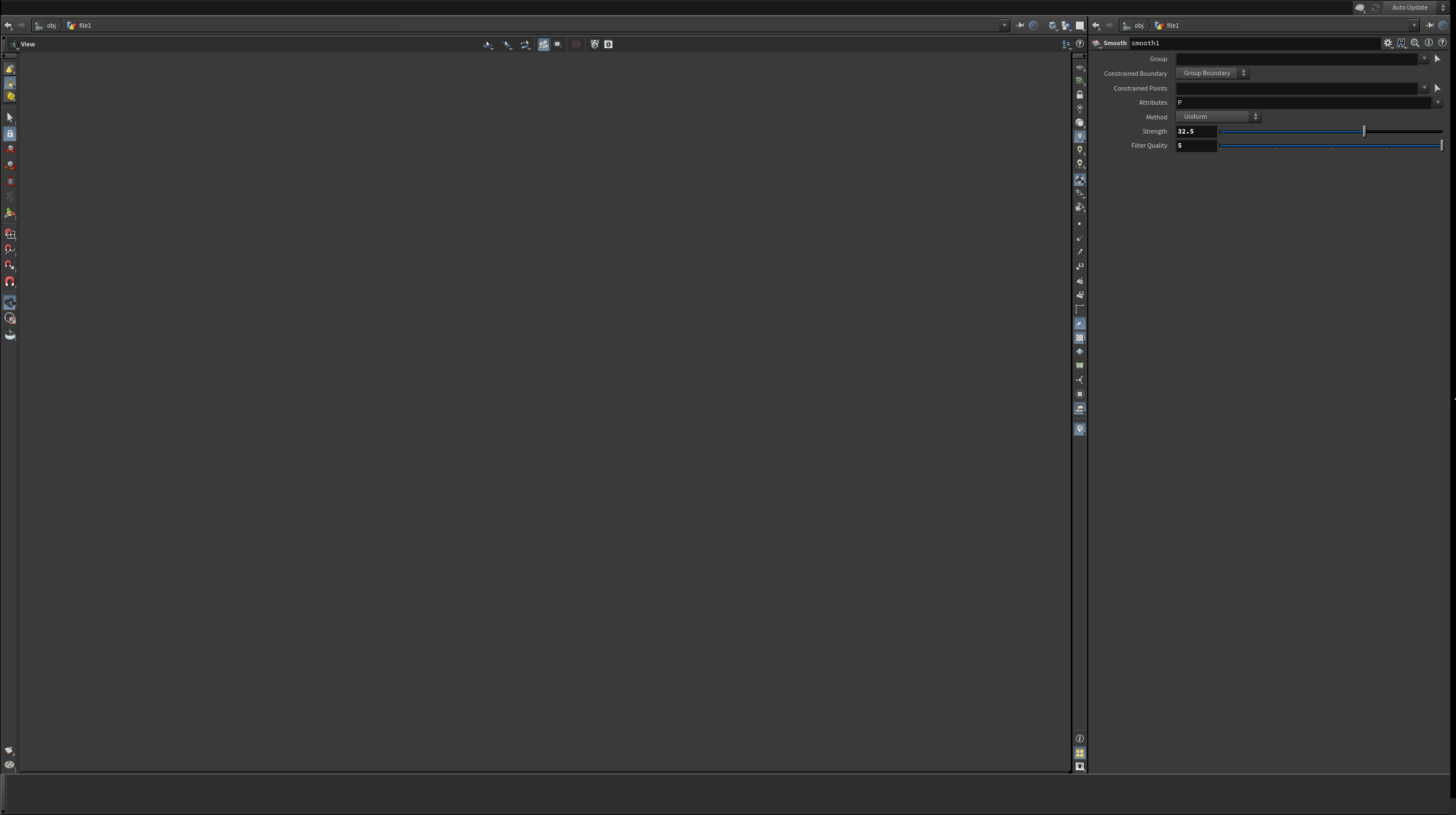

Hello, I recently bought the product and while I find its functionality excellent and everything I'd want out of it I seem to be running into a bug in which the viewport will suddenly disappear on me, often causing a break in the flow of my work.
I'm on Windows and have been working on houdini 19 and the issue seems to show up regardless of the python version.
5312 posts
Joined: 2月 2012
Can you make a short video recording of it? When you say viewport you mean the 3d viewport or the overlay network editor?
Because this extension doesn't alter the viewport itself.
Joined: 1月 2021
Attempting to record or screen capture the issue seems to momentarily fix it. Using the window's prtscn has the screen looking correct even when it is not, and attempting to use the snipping tool causes the issue to revert itself. I attached an edited version of my screen capture to reflect how the screen ends up looking. Both the 3d viewport, the overlay and the timeline disappear.
I suspect the issue may be tied to the full screen mode. Working outside of it seems to stop the issue from happening.
Having multiple monitors may also have something to do this, as I have noticed while working on full screen mode that moving the mouse to another monitor often seemed to trigger the issue.
Outside of this minor bug, I have to say it is an excellent tool, not only the overlay but the entire workflow paradigm. I'm pretty happy to have gotten it. Excited to see what future updates await it.

Joined: 1月 2021
Here's a video of the issue taking place. Since recording the screen didn't seem to work I used a camera instead.
bug.mp4 (3.3 MB)
5312 posts
Joined: 2月 2012
This looks like the Qt fullscreen issue. Can you try it after getting out of fullscreen mode? Ctrl+`
Joined: 1月 2021
animatrix_
Yes, as mentioned in my message yesterday. It works if I exit out of fullscreen mode.
5312 posts
Joined: 2月 2012
edachach
animatrix_
Sorry I didn't see that message. But yes I have experienced this exact issue on my old Gigabyte laptop. From my deep research it seems to be related to Intel drivers and Qt core issue. There isn't enough literature on any workaround though.
So your best bet is to actually not use the fullscreen mode unfortunately. Also I read before that using the magnifier tool on windows on always on top mode might help fix this glitch.
There are some new updates coming I will push soon. I also want to update the videos about it so more people can understand how to use it fully.

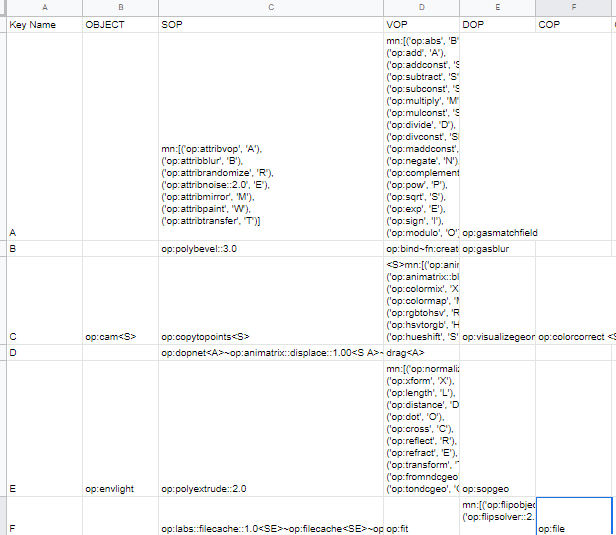

I misphrased it sorry, i meant creating nodes with hotkeys in COPs doesn't work for me. Am i doing something wrong?
5312 posts
Joined: 2月 2012
Thanks looks correct. I just tried it here, it works. It's possible I fixed this later on so I pushed a new update on Gumroad just now.
