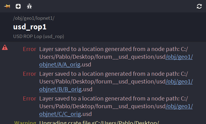

In the scene I have, the different “assets” are divided into groups (the attached .hip is a simplified example). Initially I searched for a way of using the groups to convert the geometry to USD, but couldn't find any, so I broke the geo into one OBJ node per group, for feeding into a Scene Import LOP, followed by a USD ROP (in the .hip, under ‘/obj/geo1/lopnet__SceneImport’). This worked to produce one .usd per object, although it based the file paths on Houdini node paths:
To work around this, the only way I found was to use a custom output processor (.py attached) that removes unwanted parts from the save paths. I also needed to disable “Error Saving Layers With Implicit Paths” on the ROP node, so it would downgrade the errors about paths to warnings, and cook successfully. With this, .usd files were saved where I want them, although still with warnings:
