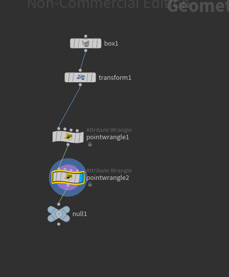

I wanted all points of my objects minus min height of the point of the object, so it can move to the grid. but apparently, it didn't work.
fist point wrangle
vector p = point(0, "P", 0);
float minHeight = p.y;
int numberOfPoint = npoints(0);
for(int i = 0; i < numberOfPoint; i++) {
    p = point(0, "P", i);
    if(minHeight > p.y) {
        minHeight = p.y;
f@minHeight = minHeight;
second point wrangle
float minHeight = detail(0, "minHeight");
@P.y -= minHeight;
Edited by zhutianci123456 - 2022年10月15日 09:04:52
untitled.hipnc (100.5 KB)
2182 posts
Joined: 9月 2015
In your second point wrangle node you're attempting to use a detail attribute named 'minHeight' which doesn't exist as a detail.
So with no actual detail attribute it reads back 0. So subtracting 0 doesn't change anything.
The previous point wrangle node you have it set to run over points so the attribute 'minHeight' gets created as a point attribute, not a detail attribute.
So you'll want to change the nodes run over parameter to detail in order that in the next wrangle node you have that detail attribute available.
Joined: 2月 2022
BabaJ
thanks, after i change to
setdetailattrib(0, "minHeight", minHeight, "set");
, it works.
