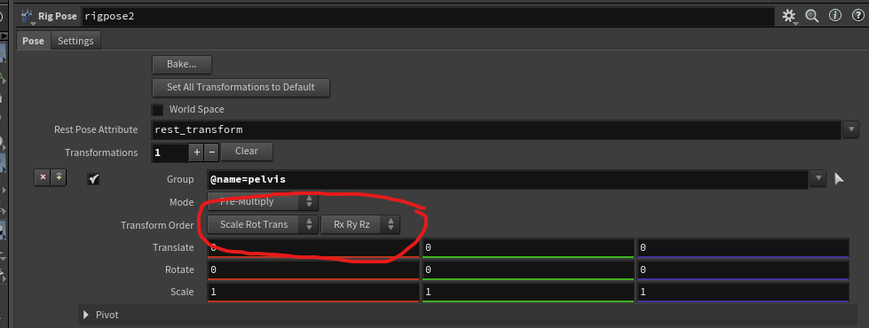

Hi. some one knows how can i change the rotation order in apex to avoid gimbal lock? i cant find it. in kinefx is easy but in apex cant find it.
thanks for your help
Screenshot (1).png (3.9 MB)

hi guilhermecasagrandi. thanks. yes i know but i want to change the order of axis transform order rotation, to avoid the gimbal lock.
normaly is in the transform parameters like in the picture but in apex animation mode. is not available or i cant find it.
