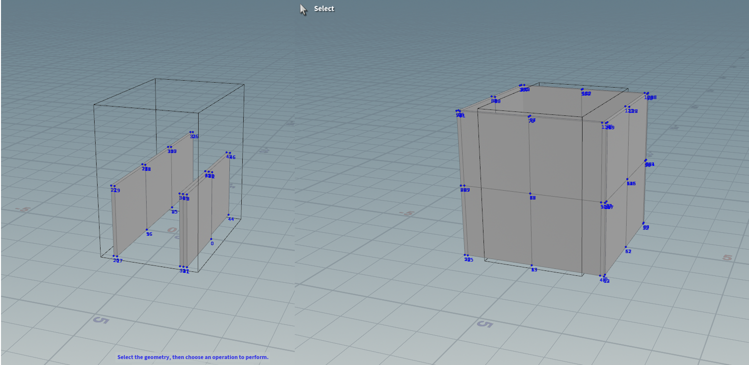

Progress report 17/09/2024
Hello everyone!
One of my teachers advised me to test out the generator in Unreal Engine as soon as possible.
Following his instructions, I found a bug that occurs when the bounding box is too small.
Another member of the teaching staff gave me the idea to force the input to always be at least 2 wall-modules in width to ensure you cannot mess up. the system is now working as expected
While I was working, I added a basic roof that uses the width of the building to determine the height of the roof. I will most likely change this after I do some more research on the topic, but this system seems to be working right now. to ensure that the sides of the roof are closed off, I added a wrangle that gives me the floor level of the last added point (the highest) and makes them a separate group. I create the building as normal and place the roof on the second highest floor, which then proceeds to Boolean and create its own side walls. To ensure that this doesn’t happen to the first floor I added an exception to the selection of the ground floor and made sure the bounding box cannot be smaller than 2 wall-modules in height.

My steps are as following:
  1. change Bounding box to determine size
  2. Normalize bounding box based on modular kit dimensions
  3. Cut up bounding box into floors based on modular kit dimensions
  4. Create curves from floors
  5. ​​Resample based on modular kit width
  6. Copy pieces to points based on location (sides get side pieces, front gets standard or alternate)
  7. Add roof through boolean of extra layer + overhanging roof if floor > 1
using these steps we get the process as seen in the gif above.

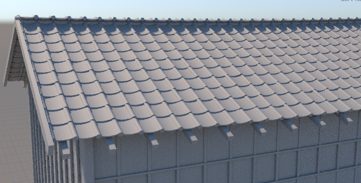

for the actual update, the first subject I want to adress is the roof.
The roof tiles are finally logically connected by a system of support beams to the roof!
I forgot to mention it in the last update, but this system is from a tutorial made by CGSide, it was very helpfull and with some tweaking I was able to make the base system and his logic to create roofs work with my specific usecase.
I have created two different rooftiles as seen above.
The main issues I currently face with the roof is that at a certain Tile-Density the roof tiles start to overlap at the top, which will be something I will work on in the upcoming project weeks to fix.
The roofs of Japanese houses are a staple to of the structures so I want to give them the amount of detail they deserve, while still trying to keep my assets game-ready. This will be a challenge going forward and may require me to rework some parts of this system again.
