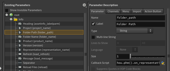

I have some custom LOP HDas that when a certain attribute changes it should trigger a value change on some other attributes. I would want this to work with context options, so that if the context options change (or render clones use different contexts) that these dependent attributes are updated along from the parameter change callback.
I'm using the Callback Script attribute of the parameter currently:
What can I do for this to support updates to other parms from this parm to trigger some 'python callback' to evaluate the result? Would that only be feasible by using some python expression instead of a parm changed callback?
