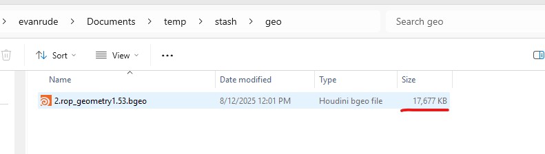

Hello,
I have 2 hip files (as shown in photo), just a rubber toy and subdivide node set to a depth of 2. The only difference in the second hip file is that I stashed the input. This causes the file size to go up, which makes sense because the geometry is being saved in the hip file. What I find confusing is how much the file size increased. It increased from 229 KB to 23,799 KB (first photo). If I save the actual geometry as a .bgeo the file size of that is 17,677 (second photo). If I add the original file size of the hip plus the size of the geometry on disk (17,677 + 229) I get 17906, not 23,799. Here is the interesting part. If I freeze the subdivide (instead of stashing it) then save the hip file (as shown in the 3rd photo) the file size is 17,906 KB. This file size makes perfect sense, because adding the original hip file size (229) + the file size of the saved geometry (17,677) it equals 17,906, which is exactly the file size of the hip file that you get when freezing the geometry. So why is the stash node taking up more disk space in the saved hip file?
