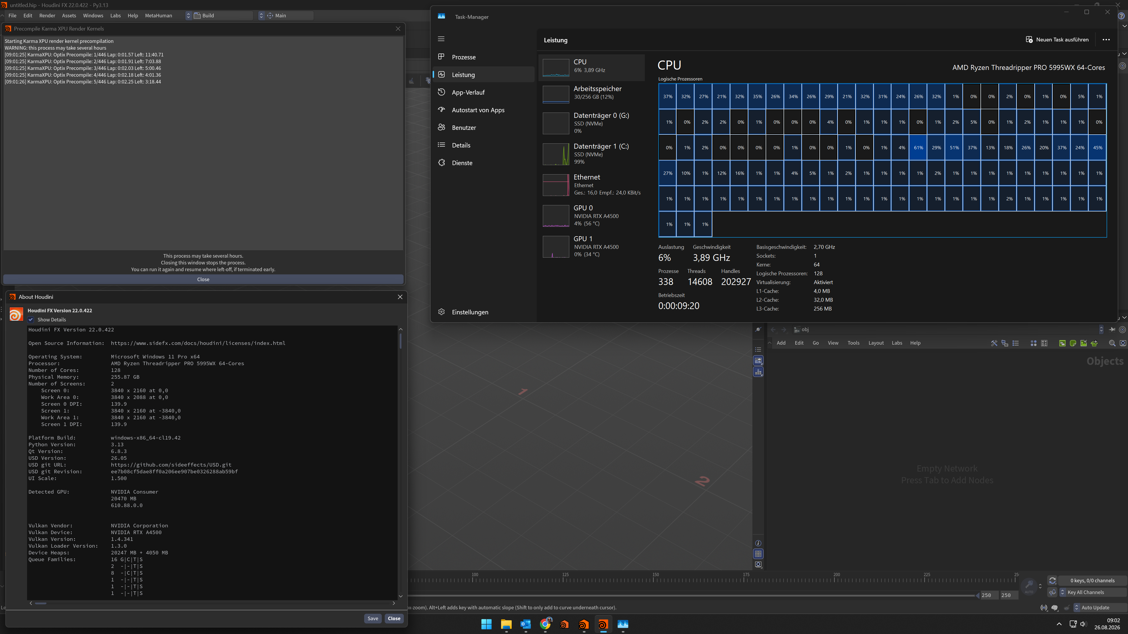

I‘ve put this in an RFE (because of the locked forum), but I‘ll post this here again:
I am on an amd 64core threadripper, two identical gpus, win11. When starting the caching, multiple (i guess 64) karma_cc.exe start up plus the houdini.exe also has cpu load (total cpu load is near 90%). After about a minute, most of the karma.exe are gone with only 1-3 remaining (cpu load is down to single digits). Not sure if the multithreading should be achieved through having multiple karma.exe running or if the processes running in houdini.exe should be more multithreaded.
This makes me wonder if this also affects the compilation time while in interactive mode (for stuff that has not been compiled yet).

I'm afraid, this still does not work for me.
What are the symptoms now? Are you able to post a screenshot like what Jason did?
Also, can you confirm you no longer have any KARMA_XPU_... environment variables set?
thanks

Well the symptoms are just like before - only a fraction of the available CPU cores are used (about 20/64cores (128threads)). Also, the used cores do not seem to be maxed out but work at around 10-50%. I can confirm that no KARMA_XPU variables are used. If I can help by running some debug code here, I am more than happy to do so.
That just leaves ronald_a now.
I think we can try a few things
eg
- do you have some kind of power-save mode enabled on your computer?
- what if you do a KarmaXPU render using only the CPU (ie KARMA_XPU_DEVICES=embree), do all the cores light up then?
- what happens if you update to latest driver as well? (616.56 dropped on Wednesday)
- what happens if you set KARMA_XPU_THREAD_COMPILE=1 again? do you see all cores light up initially as you did originally? (it means it seems to parallelize when we fire up multiple processes, rather than multiple threads).
- what total time do you actually get? Perhaps task-manager is saying low-usage, but in reality its working fine?
