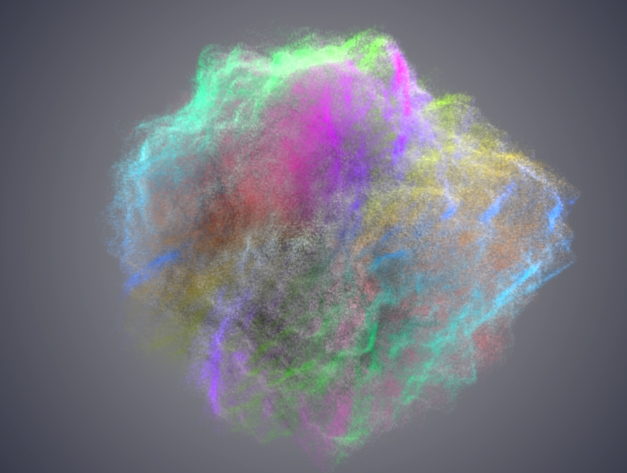

I tried a 4 million point render below. It took under 2 mins to render. I varied the particle size and coupled opacity with it. DOF and motionblur to make them more realistic and render out as points with one light and a depth shadow map. Memory is the main issue.

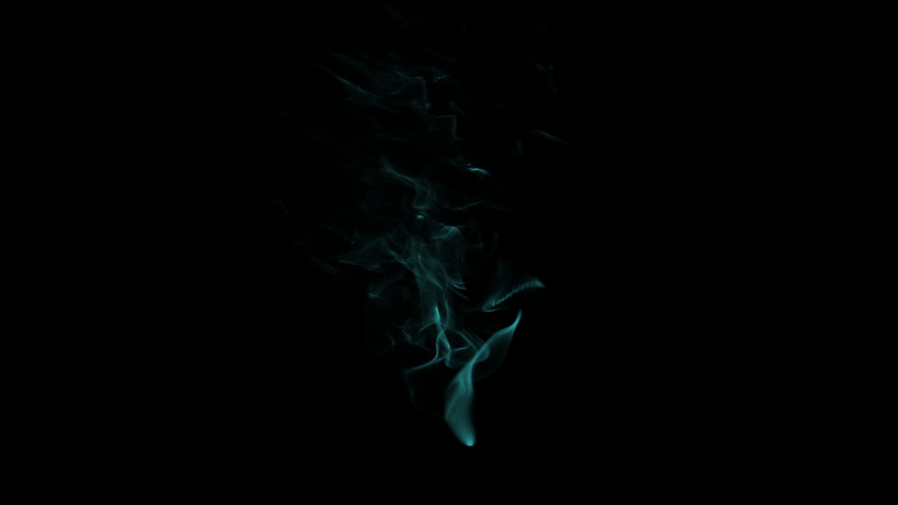

Thats an awesome time saver dude but how u managed to do it? Also rendering as points wont give me the soft look which i get otherwise with edge fall off. I want to create wispy smoke kinda effect from particles.
Heres sumthin i attempted with 2Million particles at the expense of time and space! Tuk me 3 hours to render a 100frame sequence on a 16core 12GB RAM machine.
