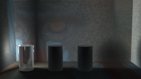

OK here's the IFD file along with the resultant image (or as I call it, “art”)
On my dual core Athlon 4400+ it was 44 minutes. This was Suse 11.2, using “gcc 4.3” build.
On my dual core laptop with T5550 1.83Ghz Core Duo, it was 60 minutes. This was Vista 32bit.
Note that I used 11.0.542 to enable the new option to disable displacement shaders (applied to the ROP). I'm including the .hip file in case people want to take a look.
However, please use this IFD file in 11.0.542 for the benchmark to ensure complete apples to apples, if at all possible. If not possible any info is OK too.
If you're on Linux or OSX, open a shell with Houdini set up and simply do:
mantra < benchmark.ifd
Note that it will write a file called “benchmark.pic” in the same directory.
On Windows, from the Start Menu, go to the Houdini version and open a Command Line Tools DOS window. Type the drive letter of the drive the .ifd file is on, hit enter, then “cd” to the directory with the IFD. Once there, do:
just like on Linux. Same thing, a benchmark.pic will be written to the same directory.
I'd love to hear about anyone's findings! I'll try this at work on 4 and 8 cores of our work machines, plus the OSX machines we just bought. On Thursday or Friday when I'm back at work, at least
