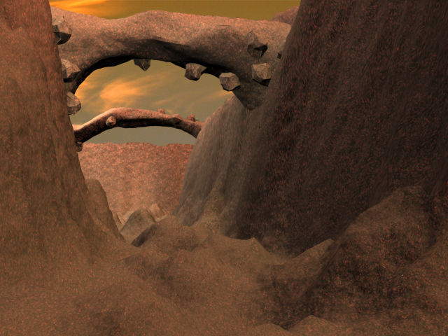

Here are some reference images, this is the mood i like to achieve.
One of them is an awesome shot from World of Warcraft: Cataclysm Cinematic!
Here's the link if you want to relive the epic-ness,
http://www.youtube.com/watch?v=Wq4Y7ztznKc [youtube.com]
