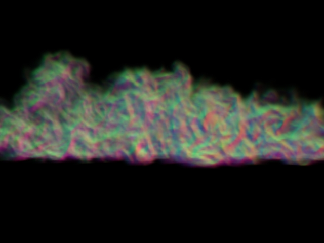

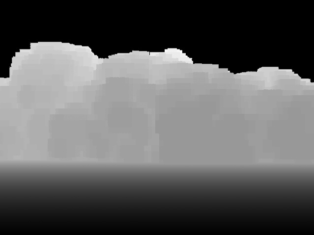

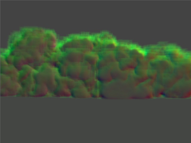

Hello,
Since last week, I am working with volumes inside Houdini, pyro smoke, and I want to have a production rendering with passes. The only image plane which works is the beauty pass (rgb) and alpha.
Also normals N, position P, depth Pz seems to work but it gives very pixelated results. My first question is how can I fix this?
My second question is how can I have more passes, what's the direct/indirect volume passes? They give no results.

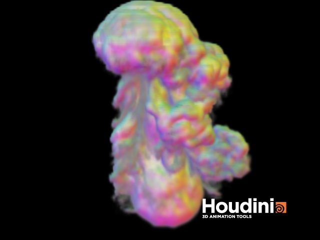

I found on the forum an alternative to create normal pass for volumes http://forums.odforce.net/index.php?/topic/14661-normal-passes-on-volume-renders/page__hl__passes%20for%20volumes%20smoke__fromsearch__1 [forums.odforce.net] but with complex mesh it seems not right. Also I cant include it in the pyro shader as extra pass, is there any way to go inside the pyro shader?

Position from volumes is ambiguous.
How do you expect a volume to generate a single P position hit? The darn volume is partially transparent and the ray can penetrate quite deeply. What kind of sorcery or manufactured magic you use to derive a P and then make it work in production is dubious at best. I have seen light shadow opacity maps to help in such sorcery but alas it is ultimately a hack and in some cases, a suitable hack to pseudo-light volumes.
Is it the first P hit of the volume or the last hit when the ray either exits the volume or gets to the opacity limit (0.995 by default I believe).
How can you fix this?
You don't. There is no answer. Hopefully you understand now.

Surface Normals on a Volume are as ambiguous as P
And then you throw out the Normal thing. Gotta love it.
Again you are manufacturing data on top of a volume to hack out lighting in this case. You can use three lights, one red, green and blue light to shade the volume. Top, Left, Right work ok. Each light shades the volume in the single color pass. In comp, you have r, g and b representing the lighting contribution from the three lights respectively. Separating these channels in comp, you now have the light coverage from the three lights to play with. A time honoured hack that works very well. That is why you see many tests with the non-intuitively lit volumes with the characteristic rgb rainbow colors.
As with P, what normal? As the ray penetrates the volume for shading purposes, most lighting algorithms assume that the light scatters in an isotropic fashion. With more advanced volumetric shaders, you can evaluate the current gradient of the volume, the spot normal inside the volume to factor in a bit of anisotropic lighting and then it really gets complex.
So the normal as with P varies as the ray penetrates and traverses the volume.
A very complex problem that currently is still very expensive as the more physically correct the volume shader the slower it gets. Ultimately as computers get faster, you'll see more options as the shaders can get more complex.
The three light trick works well.
