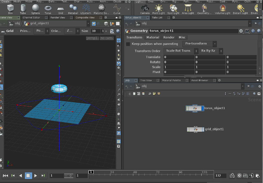

This has been driving me crazy all day!!! There's no other SOP with display flag on besides the one I'm working on right now and yet I can see geometry from at least one other geo container outside the current. It happens in either h11 and gl3.2 modes and the only way I've found to temporarily fix this is by closing my houdini session and starting a new one. Is anybody else having the same issue? Is there a better workaround than mine?
I'm using 12.5.428, on centOS 6.2, Nvidia diver version 295.20.
Cheers

4189 posts
Joined: June 2012
Cool - there's a good example on Odforce to test if you can. I managed to replicate the error first time but not since then. The subnets used, VoroniFracture, have the ForEach nodes in them as well.
Last post, page 2. mantragora's post
http://forums.odforce.net/index.php?/topic/18202-h125-viewport-displays-geometry-that-its-not-supposed-to/page__st__12 [forums.odforce.net]
5339 posts
Thanks (and thanks to Mantragora). I will give it a spin.
Edit: As it turns out, the video starts after whatever steps were taken to end up in that situation. So unfortunately, while it's a good demonstration of the results of the bug, it's not very good to reproduce the bug. I did attempt to follow the steps he mentioned, but couldn't get it to produce the bug. There is a bug fixed in 12.5.496 (tomorrow's build) that corrects a couple of cases of missing geometry, though.
4189 posts
Joined: June 2012
Cool - I was able to create the error using a SopSolver with a pointjitter inside. Working on making it consistent.
SopSolverStuckViewPort.hip (165.9 KB)
