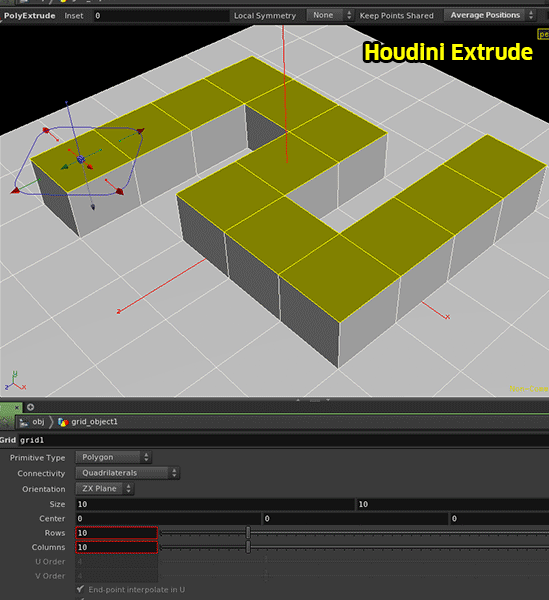

Before submitting RFE or something, I would like to post here and discuss about this 2 problems who I'm sure affect could affect deeply our production speed.
Extruding and Insetting
The houdini extrude tool works as expected but when it comes to insetting, none of the presented option product in my point of view the right behavior. This is just too important to be missed.
Beveling Groups of polygons/points
The number two tool not to forget.
On Softimage the bevel tool computes correctly shared/points/edges. Plus there is a “manage collision” option checked by default who deal with colliding corner.
This colliding thing happens all the times when you extrude and bevel things, this is just not to be missed ;-)
The Softimage Tool provide all the option needed avoiding heavy manual geometry fixing.

The gifs are quite hard to follow due to the rather complicated nature of the problem. It might be better to show individual pictures.
Also, make sure when you make a comparison between the two, you use the same mesh and operate on the same components (edges, polys).
174 posts
Joined: March 2014
yearr i know, will do that tomorrow
