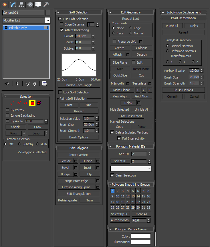

all it needs is a polymodel sop which can do all the poly operations (extrude, bevel, edge collapse etc. ) in one node. wasnt this the case back in the days?
This is EXACTLY what I am talking about. Just imagine there is a Model node that has all the tools you need in there, just like 3Ds Max. Why should I leave Houdini to other packages when I have such a tool that contains all the modeling toolsets that I need?
The example below is from 3Ds Max's editable poly object. You can convert anything into editable poly and work in there without even adding one single deformer or modifier (well even if you need you can collapse it back to the editable poly)
