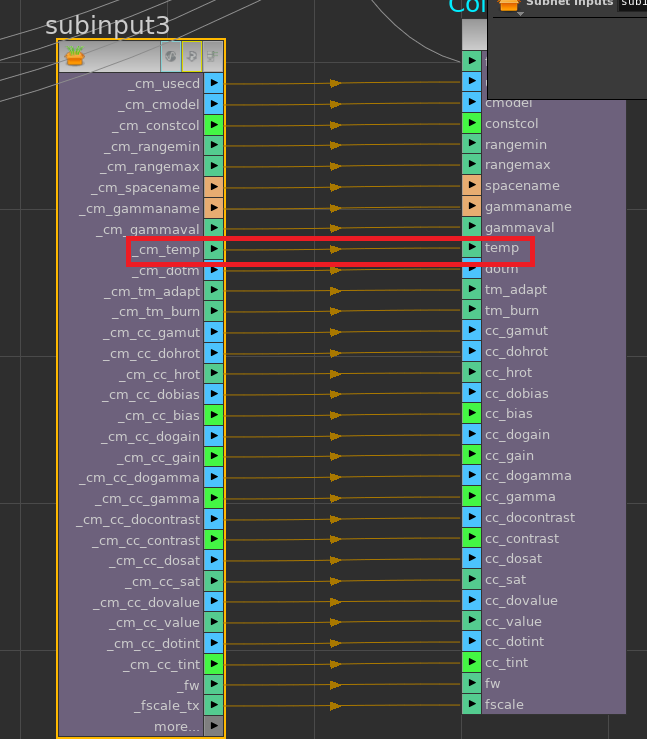

I tried to make out and could not understand exactly how the temperature fields are converted into color and intensity. Initially, values come in ranges from 0 to for example 650 and nonlinearly turn into a color of the pyrovolume. Unfortunately, the pyroBlackbody and PyroShadercore nodes are black boxes and it is unclear what is happening there.
