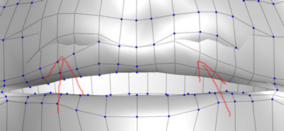

The problems seems to be related (or somehow triggered) to introducing Edit nodes that feed into a Blendshape. It keeps happening. It superimposes geometry that should NOT be showing.
Thanks to Tamte I clear the cache and it works… but it is frustrating. I'm guessing he's had experience with this issue too.
Check out my attachment of overlapping geometry in the viewport.
