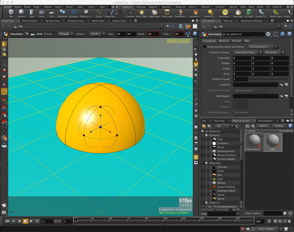

Now I setup a simple scene with a grid and a sphere. I added a clay material to the grid and a mantra Surface Material to the Sphere. All good so far. Then I went and updated the shader ball icon. The shader ball icons turn greyed out with a red cross in the bottom corner (see attached image) and in the Houdini shell the following message appeared. The bit highlighted in bold appeared when updating the shader ball icons:
Last login: Thu Nov 20 15:36:51 on ttys001
Mac-Mini:~ johnathanjoy$ cd /Library/Frameworks/Houdini.framework/Versions/13.0.582/Resources;source houdini_setup; cd -
The Houdini 13.0.582 environment has been initialized.
/Users/johnathanjoy
Mac-Mini:~ johnathanjoy$ hkey
Mac-Mini:~ johnathanjoy$ happrentice
Mac-Mini:~ johnathanjoy$ No licenses could be found to run this application.
Please check for a valid license server host
Traceback (most recent call last):
File “/Library/Frameworks/Houdini.framework/Versions/13.0.582/Resources/houdini/soho/python2.7/IFD.py”, line 490, in <module>
forphoton=isphoton)
File “/Library/Frameworks/Houdini.framework/Versions/13.0.582/Resources/houdini/soho/python2.7/IFDframe.py”, line 1000, in render
skipobject, skiplight)
File “/Library/Frameworks/Houdini.framework/Versions/13.0.582/Resources/houdini/soho/python2.7/IFDframe.py”, line 975, in renderObjects
File “/Library/Frameworks/Houdini.framework/Versions/13.0.582/Resources/houdini/soho/python2.7/IFDframe.py”, line 918, in outputObjects
outputInstance(objinfo.obj, now, objinfo.check_renderable)
File “/Library/Frameworks/Houdini.framework/Versions/13.0.582/Resources/houdini/soho/python2.7/IFDframe.py”, line 719, in outputInstance
IFDsettings.outputObject(obj, now, check_renderable=check_renderable)
File “/Library/Frameworks/Houdini.framework/Versions/13.0.582/Resources/houdini/soho/python2.7/IFDsettings.py”, line 448, in outputObject
_outputShaderList('object', obj, wrangler, now, oshaderParms, oshaderSkipParms)
File “/Library/Frameworks/Houdini.framework/Versions/13.0.582/Resources/houdini/soho/python2.7/IFDsettings.py”, line 310, in _outputShaderList
getattr(parm, “ShopType”, soho.ShopTypeDefault))
File “/Library/Frameworks/Houdini.framework/Versions/13.0.582/Resources/houdini/soho/python2.7/IFDapi.py”, line 121, in ray_shader
print shader
IOError: (32, ‘Broken pipe’)
