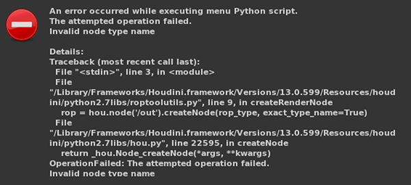

6 posts
Joined: July 2014
Hi
I have the same problem and I also tried to open Houdini from Houdini Shell, typing> Houdini
Houdini starts but Mantra node is not working anyway.
Is maybe wrong what I type?
Randomly, in the past days it worked a couple of time.
here's the message that appear after I click on Create render node>Mantra:
Schermata 2014-11-18 alle 20.20.47.png (98.4 KB)

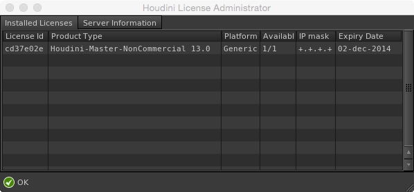

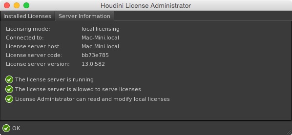

8147 posts
From the terminal, try starting “hkey” which is the License Administrator. Make sure this says that it has a render license.
59 posts
Joined: Oct. 2010
edward
This is what License Administrator shows when launching from terminal with “hkey”.

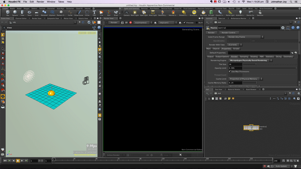

59 posts
Joined: Oct. 2010
Below is what i type in Terminal to launch Houdini:
Mac-Mini:~ johnathanjoy$ houdini
Houdini Launches fine I set up a simple scene with a skylight and camera and create a Mantra render node in output and hit Render. Terminal updates to show the following:
Mac-Mini:~ johnathanjoy$ No licenses could be found to run this application.
Please check for a valid license server host
On quitting Houdini the Terminal updates to show the following:
2014-11-19 13:29:49.823 houdinifx 13:29:49.823 ERROR: >aqsrv> AQServer.cpp:70: APIException: Exception caught in AudioQueueInternalStop_Sync - error -66671
As you can see in the render pane it hangs on Generating Scene…
