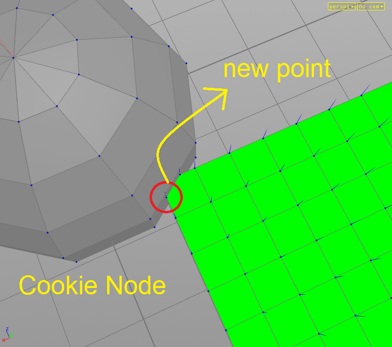

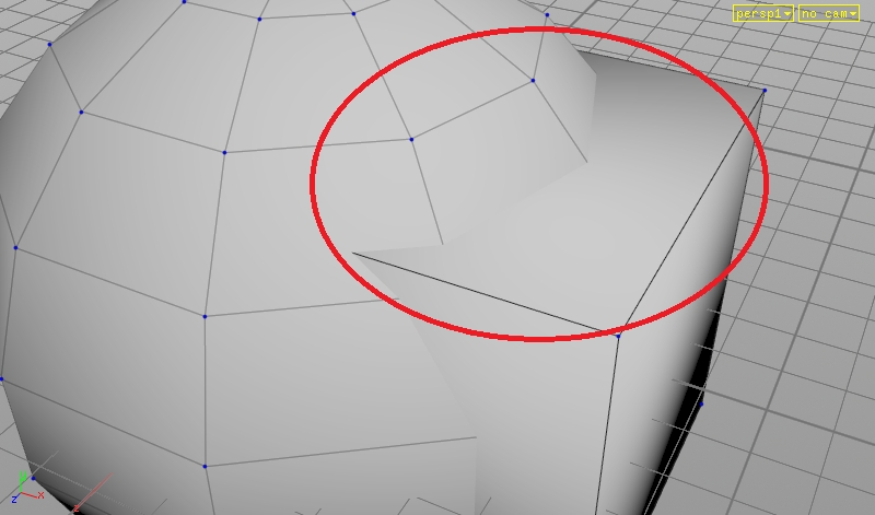

Joined: Nov. 2013
Doodlez
If your intersecting geometry has a very basic shape you could create a curve with the outline of your geometry and project it on the other piece of geometry.
i check behavior of cookie sop. nearest Order to that from VEX is Intersect.
see two image for that one for cookie and one for simple VEX intersecting.
as you can see cookie in first interaction between two object create new point and after that point just create new point on each edge of your intersecting object(in this image sphere).
so in VEX intersect function we need to understand houdini when and where create new point.(simple intersect is very good for car accident if you don't want to have massive cloth simulation for deforming car…)
in this case i use red color for border edge but color maybe haven't high precision for houdini to distinguish intersect area.
so we can use environment of each primitive and i think it's high precision way to understanding houdini for create new point.(each intersect cause to environment of same primitive start to change)
i still working on that and i think above Description good for start…
