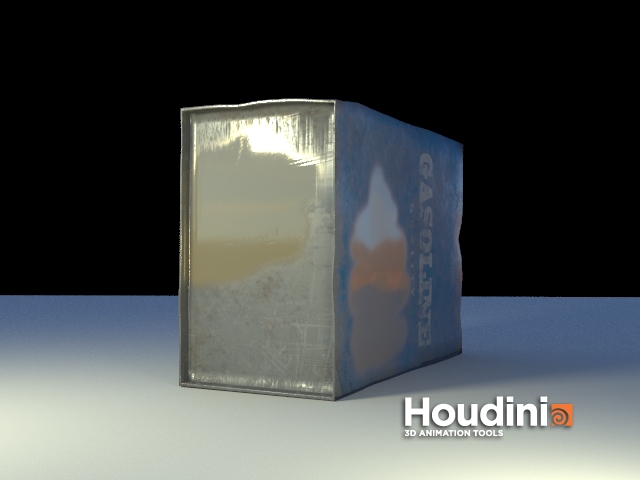

Ok, i've almost got it working.
Only(maybe) problem i have now is, my texture is repeating, the full texture on each side on my box, insted of wrapping the whole box with the texture, and that goes for all maps(diffuse, normal, roughness, metallic…etc)
where do i find parameters for scaling, position etc.?
(I've imported a deform box created in Blender, and uv unwrapped, texture painted in Substance Painter)
EDIT: BTW import an OBJ, and im using the mantra surface
Thx
20 posts
Joined: Aug. 2015
I did a test with FBX, and then all maps fit perfect (i think)
I dont know why OBJ isnt working as it should.
My solution for now:
Import FBX, add Principle shader, apply maps.
- mess with metallic and reflect settings
