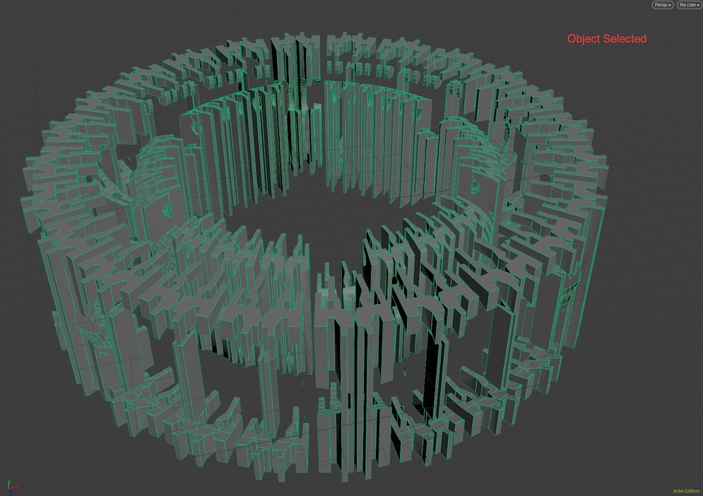

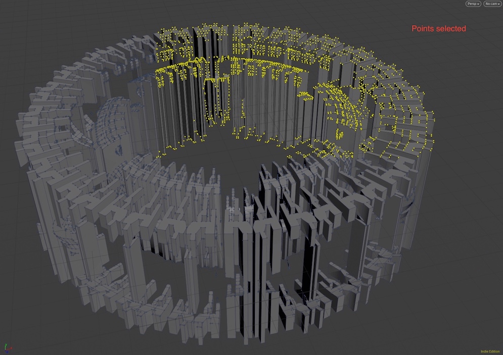

One step further here.
Just found out that the UI and viewport schemes are not locked to one another, so you can set them in two different schemes.
So the “Edit>Color Settings>Color Scheme>Houdini Dark” does something different than the “D>Background>Color Scheme>Dark” viewport option.
Changes in the 3DSceneColors.dark file will only show up when the latter is set to the file changed in your user/houdini/config folder..
rob

OK,
First steps here
I also tweaked some of the viewport settings (mostly visibility stuff), this is saved in a ‘Visualizers’ file.
3DSceneColor.dark file, copy into user/Houdinix.x/config folder [rowumedia.nl]
Visualizers file, copy into user/Houdinix.x root folder [rowumedia.nl]
rob
P.S. it's a v0.1, so stuff could break something somewhere…..
And if someone can point me into the right direction for the yellowish overlay color for the hover, that would be great!
