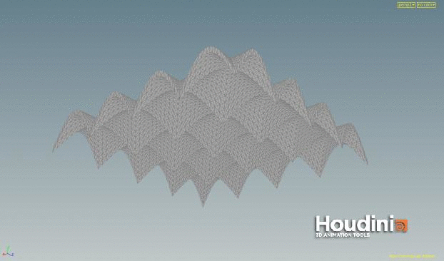

architectural components are defined by mathematical formulas. So wrangles and VOPs might become your most effective tool for creating shapes inside Houdini.
Here is an example on turning a flat box into a vault roof:
vector bbox = abs(sin(relbbox(0, @P) * $PI * 4));
@P.y += max(bbox.x, bbox.z) * @Time;
Edited by Konstantin Magnus - Dec. 14, 2016 20:06:23
vault.hipnc (56.0 KB)

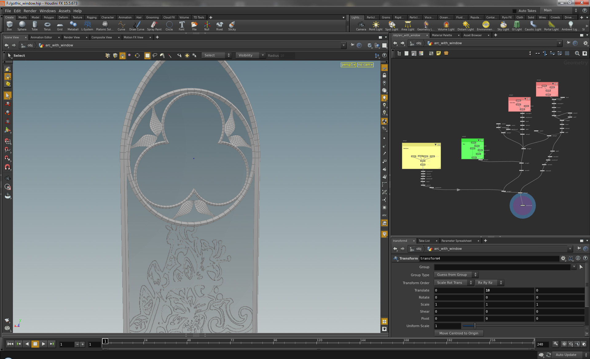

483 posts
Joined: Dec. 2006
Basic Example with trace, curve sect and skin nodes.
Houdini has a sculpt node, too.
I totally agree with Konstantin :-)
Procedural or not is the question.
Ray Example added… to many possibilties in Houdini ;-)
Edited by matthias_k - Jan. 4, 2017 17:04:45
gothic_window.hip (429.7 KB)
