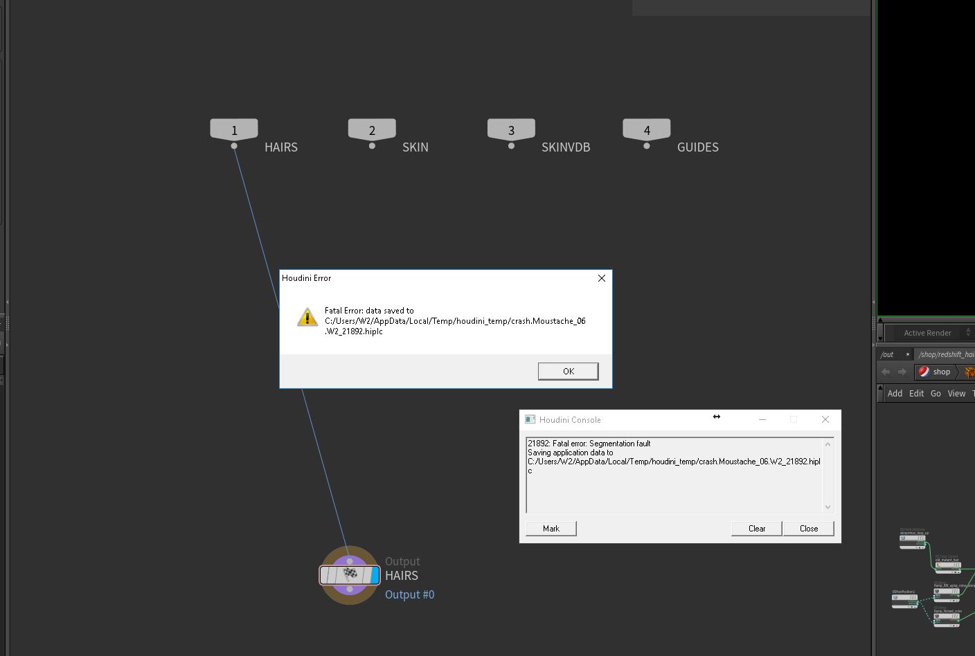

Hey guys, I'm experiencing a LOT of crashes when grooming hair / fur (set length / Paint length atm) in Houdini 16.0.504.20. Is there some known bug / issue? I'm not doing anything crazy but just trying to add several layers of set / paint length and animate that length as well, but Houdini is crashing randomly way to often for me to go on working.
Any idea what's up?
Cheers,
A.
https://www.dropbox.com/s/ikhnadr6x6vjuv7/Moustache_04.hiplc?dl=0 [dropbox.com]

8161 posts
What's in your crash log?
436 posts
Joined: June 2015
To tell you the truth i'm not sure where to find that crash log. Noobs here. I checked C:\Users\XXX\AppData\Local\Temp, but couldn't find any file that seemed related to my crash.
Here is a simple scene with Redshift 2.5.05 and Houdini 16.554, and it crashes on IPR render instantly.
Either way, the issues i'm having with Hair / Fur in 16.504.20 that i was trying to resolve by moving up to 16.557, are still taking place in 557 anyway, so i'm in real trouble now, as pre-production or not i do need to start delivering some hair / fur attemps and it's a real pain to move forward with such shaky workflow.
https://www.sidefx.com/forum/topic/48991/?page=1#post-221217 [sidefx.com]

8161 posts
Adriano
chrism
Please log a bug. Thanks!
I've never done it before. I'm not quite sure i even have access to that part of the forum. But i'll make sure to look into it tomorrow.
The second sticky post in the forum is relevant here: https://www.sidefx.com/forum/topic/15603/ [sidefx.com]
Adriano
It should be in the same directory as where it says it saved the crashed scene. ie. C:\Users\XXX\AppData\Local\Temp\houdini_temp. Look for something named “crash” and has the “.txt” extension.
8374 posts
Joined: Sept. 2011
Looks like Redshift isn't compatible with any current builds. I think the last build it worked with was around ~540. The release build is still available, and I know Redshift had a version compatible with that one.
https://www.redshift3d.com/forums/viewthread/11613/ [redshift3d.com]
