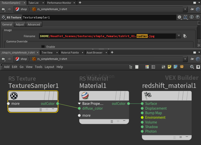

I guess this is really more my problem, I am very new to houdini so I'm sorry if this is a dumb question. I finally figured out last night how to setup a shader on my object but the hurdle now is making sure a UDIM texture actually shows up. I have the RSMaterial working but everytime I add the RSTexture to the Material the object just goes black. The RSTexture already sees that it is a UDIM set but I dont know if I have to put something inbetween the texture and the shader to get it to work. I also looked at the UV's in Houdini and all the tiles are there and in their proper place.

I just started using UDIM textures in Redshift. I extracted the textures from the Houdini Simple Female character, which use UDIM values.
I don't know if you are aware of this, I wasn't till a few days ago, but there is a special <udim> token that you need to put in place of the actual udim numbers in the file name.
Check out the image.

Yup that did it, Thanks a lot. I was able to get my character setup in Houdini.
