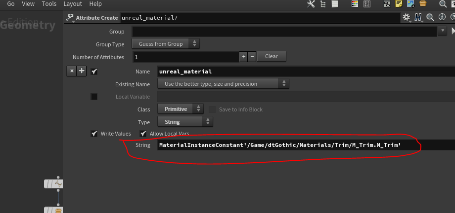

To do what you want you need to assign the material attribute to the group you wish that material to have. So you need to make sure you are not assigning your attribute nodes to all your geometry in your asset.
Also the materials you put in each material node must be different or they will be combined.
So when you copy source from unreal use different material for each different material you want to have and then make sure your attributes actually have different geometry in them.
Hope this makes sense.

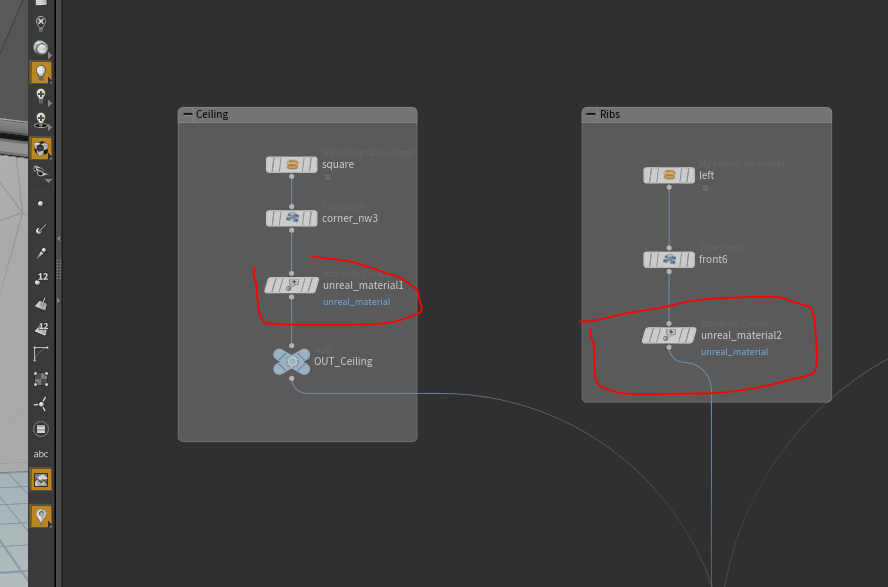

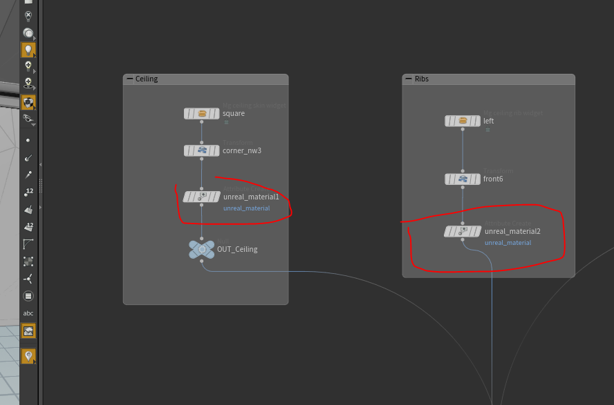

I am attaching image that shows two separate nodes that are merged in the asset. Each node has material assigned before they are merged so the material attribute is applied only to that specific set of geometry.
Then each material attribute references a different material in UE. If you use same material name they will be considered same material.
Looking at your material attributes your problem is you are applying both materials to the same group of geometry. You have to assign them to different set of polys for this to work. That is the power of grouping, that you can isolate a portion of your model and modify just the portion. There are two ways you can approach this and will usually depend on how you structured your asset. If you build the pieces separately and then merge them you can just apply a material attribute as I did in the image below. If you model is more complex you can use the create group node to isolate the different parts and then use that group in your material attribute node so it only applies the attribute to your grouped geometry.
Once you get this setup properly the materials will be assigned automatically by the digital asset.

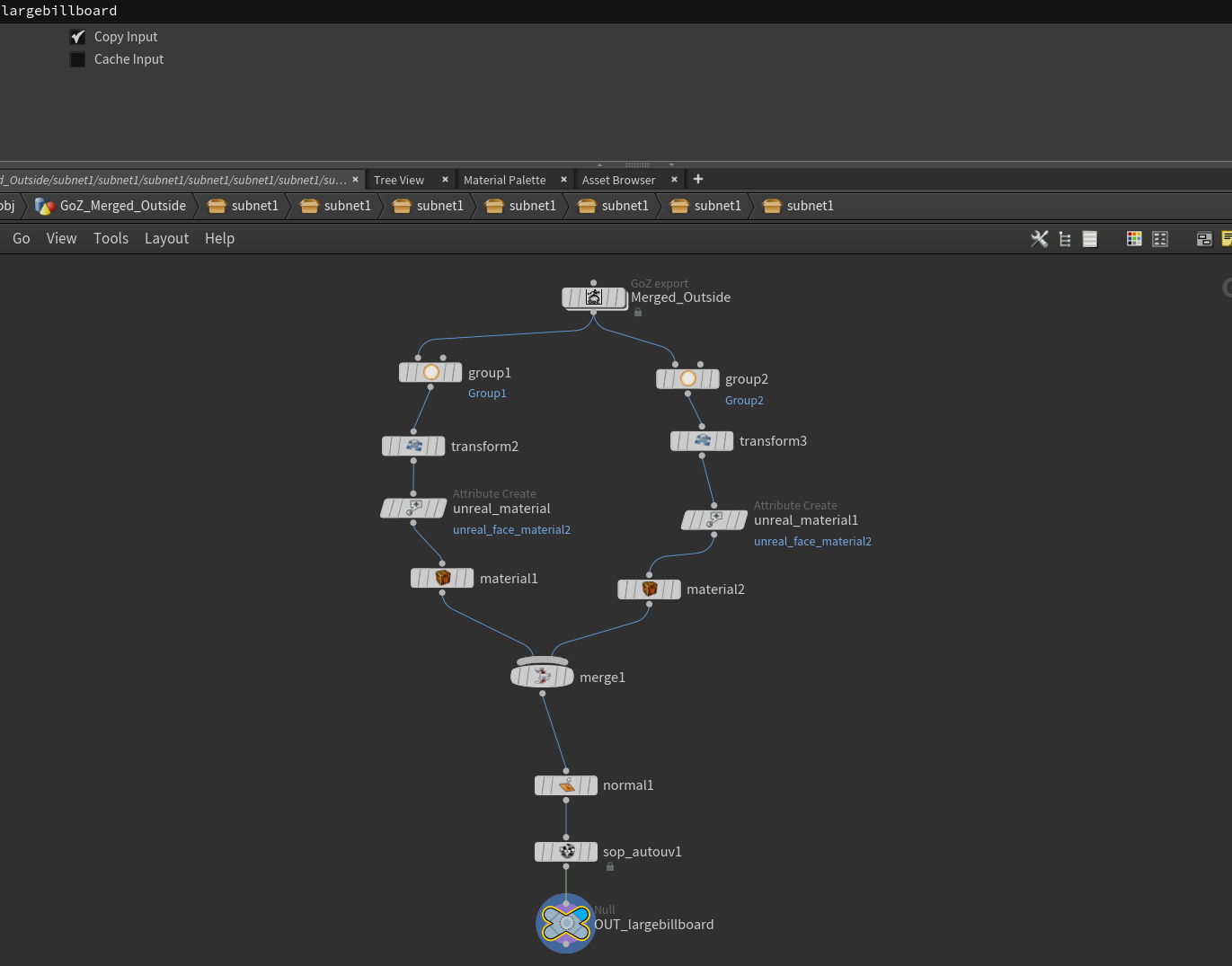

Hey, thank so much for this, still can't get it to work though.
I am using a merged object from Zbrush (imported by GoZ) but I have retained the separate material groups, so was able to split them off using the group node as you suggested. I made an HDA without materials and one with with materials, but Unreal does not register either as having 2 channels. Here are the images of what I have

Snappy_Darko
for each of your material groups rename them both to just
unreal_material
unreal_face_material is deprecated.
yours currently have a 2 at the end.
I am not sure about the actual material node you have on there. I have never used it with material from houdini.
I use the copy reference to reference a material that already exists in UE (someone else might comment on the material node)
Try fixing the group names. If that does not I am not sure I cannot determine if those are valid groups or not.
A good way to test this out is to create a very simple asset with two sets of geo (two boxes), put each box in a group at the material attribute node for each and merge together. Then use this to test until you get it. Once you have that working you can use it as reference for work on your zbrush import.
