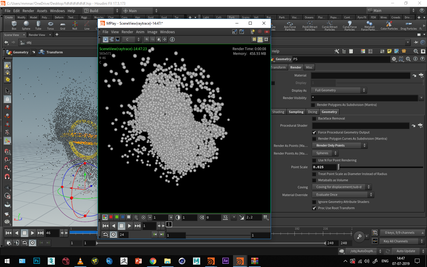

Using your suggestions I did find indeed source_particles>Render>Geometry>Render As Points property.
Setting as No Point Rendering didn't produce any output. Setting as Render Only Points you can change the point size using the Point Scale and achieve nice results.

I too have the same issue..
No matter how much i decrease the size of particles its still displaying the big sphere
