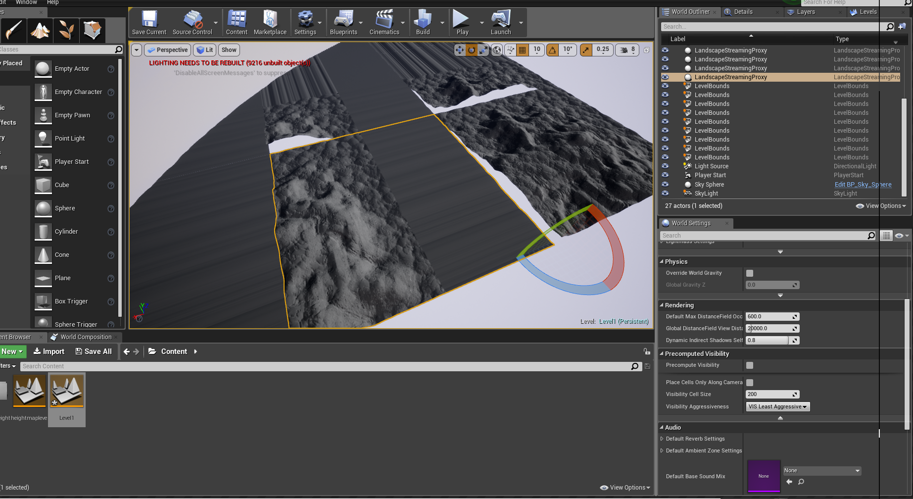

So was going along with this UE4 tutorial on world outliner using tiled heightfield maps and had a few issues, namely below - is what Houdini produces when exporting a tiled heightmap (or black tiles). Flip Y on or off in Unreal is still a garbled mess. Anyone have any idea or has successfully done a tiled landscape in Houdini to UE4?
I'm exporting tiles via a heightfield output node.
Is there a better way? What's the upside to Heightfield Split or making an HDA? Can an HDA heightfield possibly be more efficient?
Also Unreal wants very strict naming conventions - name_xNumber_yNumber but the heightfield output node doesn't offer that - anyone know a code to fix that? Not sure what to do as you're forced to use Houdini's built in tile naming and don't want to rename 16-64 tiles manually.

Both the naming issue and the heightfield output tiling issue are known bugs.
I'll let you know when they are fixed.
Unfortunately, using a HDA and a Heightfield tile node to export the data to UE4 through HEngine will not solve your issue for two reasons:
- the heightfield tile node doesn't have an option to share the edge vertices between the landscape tiles, so there will be a missing strip between each landscape. Trying to fix this by using padding on the tile node will create overlaps.
- The world composition workflow in UE4 really needs image files inputs, whereas an hda will populate a level with one or multiple landscapes.

The Heightfield output issue was fixed in the latest daily build (16.0.694).
Still no x_y naming convention for now, I'll post an update here when that RFE has been added to the build.

Unfortunately, HDA containing tiled landscapes (via the Tile Split nodes) won't work with world composition:
When imported in UE4 via the plugin, they will give you properly sized/placed landscapes, with layers, and thanks to the upper/lower tile overlap parameters Chris mentioned above, without any overlap.
But the World composition system in Unreal only works with image files, and wont accept Landscape Actors.
(our original goal was to try to hook up tiled heightfields directly to World composition, but until it gets some form of update, this wont happen as the system really expect manual user interaction…)
The only solution you have is to bake out the Heightfields to image files via the heightfield output node, using the x_y naming convention expected by Unreal.
