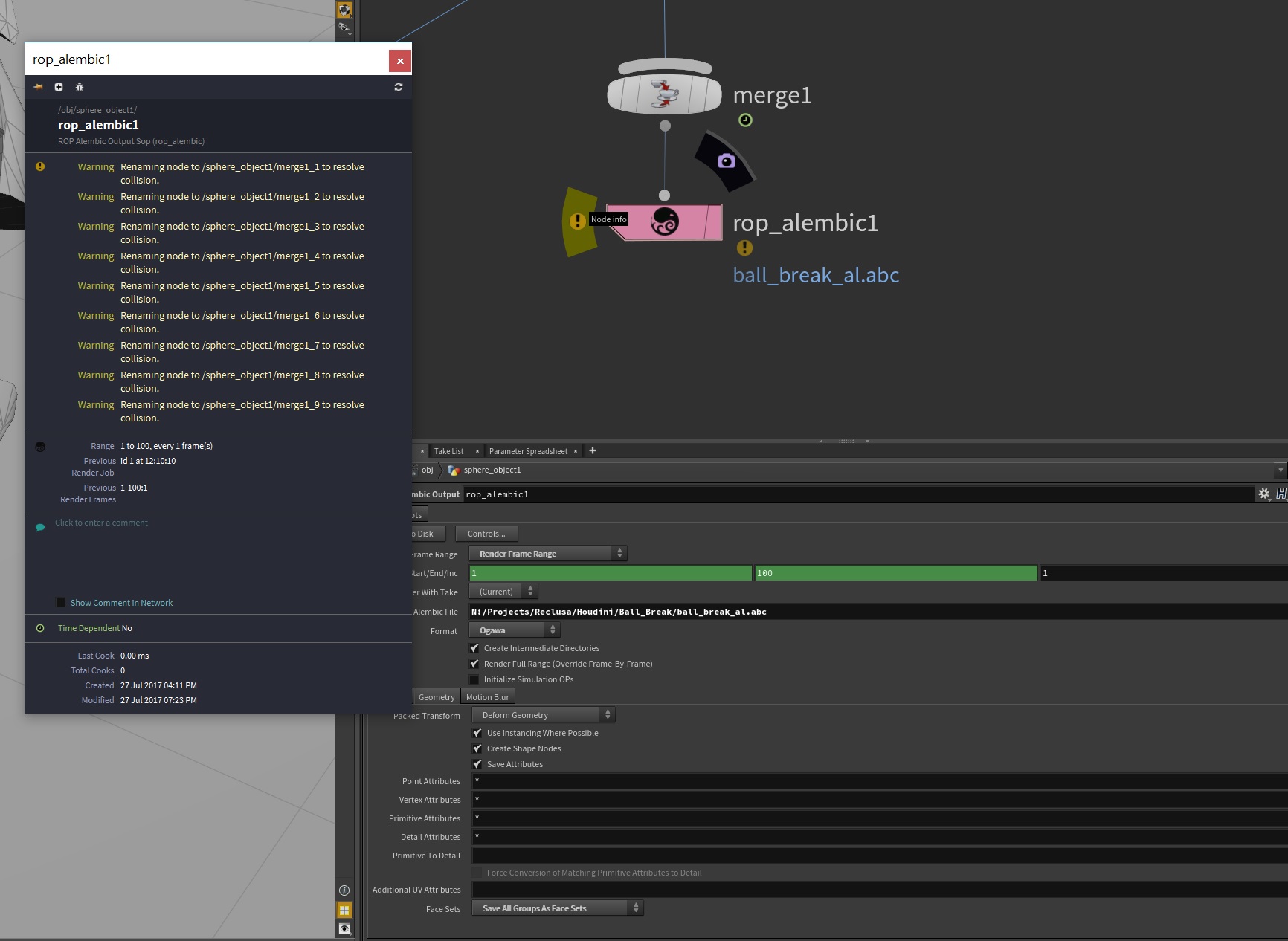

Also I have a warning in Houdini that I am not sure what to do with. “Renaming node to *”. (Image ball_export)

I suspect you are trying to export a collection of Packed Fragment primitives (or Packed Geometry primitives) for your object. This will result in a shape for each piece in the resulting Alembic archive. The warning is likely because you didn't specify a unique name for each piece so the Alembic ROP renamed some of the pieces. If you want a single object with deforming geometry, consider inserting an Unpack SOP before rop_alembic1.
