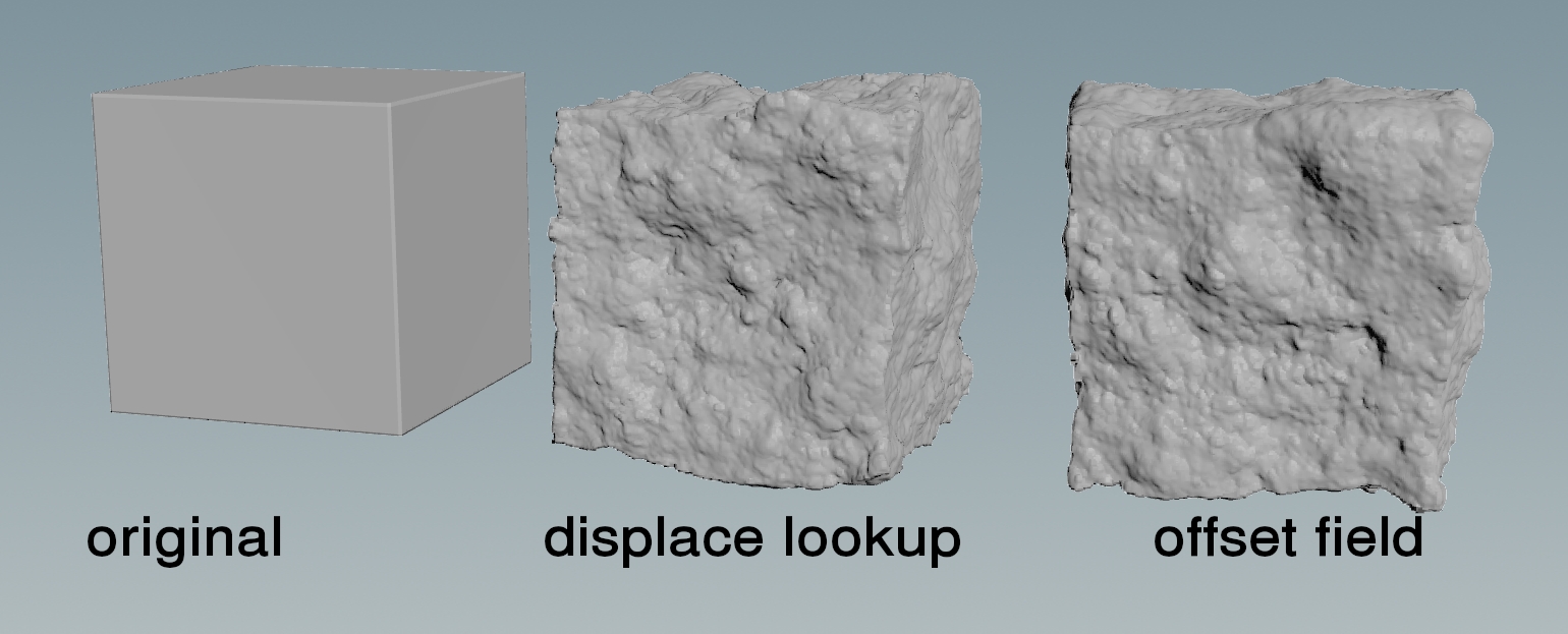

two main ways to do this nic. first thing you'll want to do is to export your field as ‘surface’ rather than ‘density’. its as easy as changing the name of your export variable in your vop or wrangle.
to displace your ‘surface’ field, you can either displace the lookup or offset the field. displacing the lookup has the effect of moving the surface around in space based on your noise field (vector noise). offsetting the field is changing where in the volume the limit surface is drawn based on the noise (float noise). the differences are subtle but appreciable. here's an example of both.
