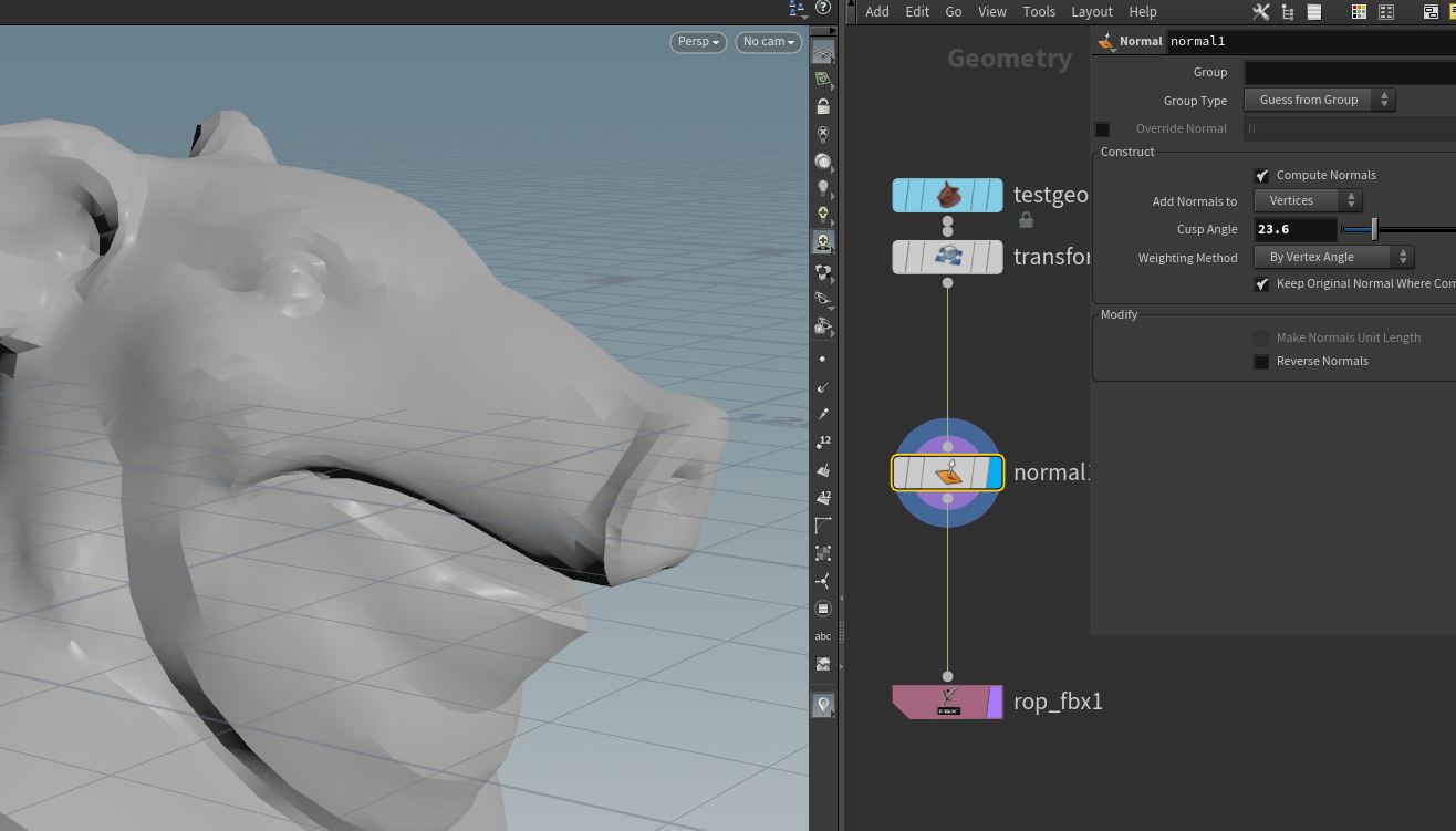

Providing an update to this. As of Houdini 19.5/20, the ROP FBX node now features a "Compute Smoothing Groups" toggle parameter. Ensuring your geometry has vertex normals present (e.g. using the Normal SOP node), enabling this toggle parameter will save smoothing group data to your FBX. Importing the same FBX to UE5 should no longer cause the "No smoothing group information was found in this FBX scene!" warning.
This toggle can also be found in the FBX Character Output and FBX Animation Output nodes.

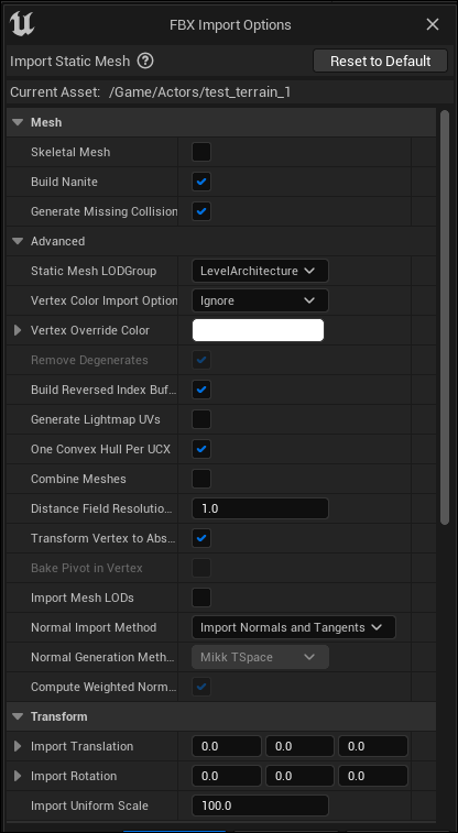

I just tested with 20.5.445 / UE5.5.1 and the rubber toy with Compute Smoothing Groups on, and for the import, I turn off Recompute Normals and TangentsImage Not FoundImage Not Found
No error popup for me....
It doesn't pop up in the message log but in the output log you still see the smoothing groups warning. It's not the end of the world but still not a full solution I think.
