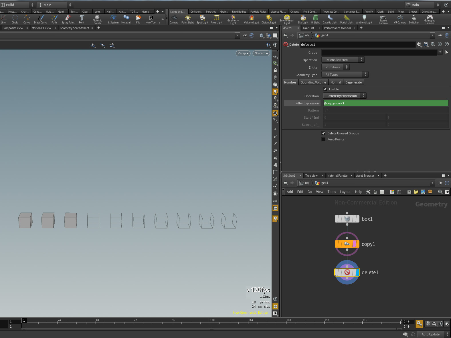

stephenanimation27
Thank you that works! If you wanted to do this with a copytopoints node how would you do that?
Not sure if i understood your question…but if you have the point numbers BEFORE the copying process…then simply manipulate the point numbers with a plethora of methods…then copy to the new subset of points ?
The copy to points doesn't have the ‘create group name’ option I don't think.
- stephenanimation27
- 27 posts
- Joined: Jan. 2017
- vusta
- 555 posts
- Joined: Feb. 2017
stephenanimation27
Thank you for making that video that explained a lot! I am a little bit confused when you say having the point numbers before copying. How would you find out the point numbers before you have created the copied geometry?
I meant if you use copytopoints…..then the template points you feed in to the 2nd input, manipulate them first BEFORE you feed them in
so if I make a line, give it 20 points, I want to copy boxes to these template points, then use groupbyrange say on the LINE points to select every 3rd point (just an example), then feed these into copytopoints
