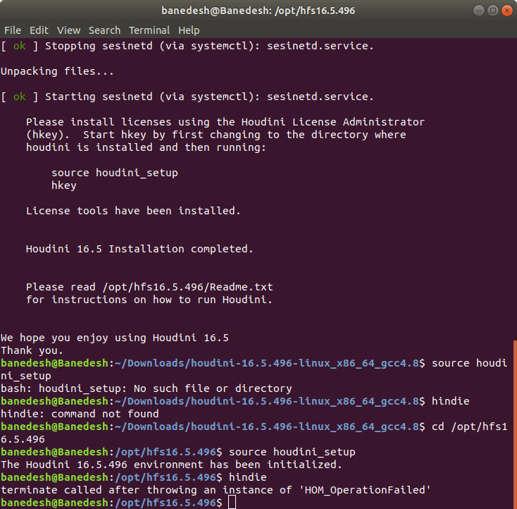

I just installed Houdini 16.5.496 on Ubuntu 18.04 and I get a crash on launch.
I can still launch and use H16.5.378 just fine.
Any tips on how to get past a “HOM_OperationFailed” error?
Edited by Enivob - June 12, 2018 12:27:57

My issue was a 3rd party render system, Redshift was not compatible with the .496 release. Once I upgraded my Redshift to the latest version, which is matched to the H16.5.496 API, and altered my houdini.env to point to the new plug-in Houdini launched just fine.
This API mis-match could be an issue for Arnold users as well.
