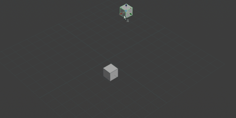

Hello, is it possible to move an object snapping to points/curves/grid but clicking directly on a specific point, without using the manipulator ? It's something I do all the time in Maya (on Maya documentation it's called “snap a move”) and saves a lot of time, maybe in Houdini it's possible but I don't know how.
I attached a clip to better show what I mean.
Thank you
Ray
"Snap a move" like in Maya

No, but I also really miss this mode (as an upgrade of “secure selection” mode ?) and not only with snap (drag and move in viewport with any active axes) without losing time to fine select handle many hundred of time during by daywork.
However you can just middle click and drag with the snap active hover your target without selecting handle.

Not sure but isnt this possible already with Start Orientation Picking.
you can hold down the key: ;
to temporary go into that mode. Then you can just click where you want to move the handle to.
Make sure you use a US Keyboard layout. otherwise the shortcut might not work.

@Doudini yes! I discovered this function today, it's completely hidden and undocumented. It works, a bit rudimental but it works.
