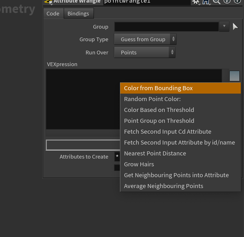

Is it possible to add more VEX Presets to Wrangle nodes?

Just wondering if anyone knows how it might be possible to add more pre-coded VEX presets to the various Wrangle nodes in addition to the limited number which are already there?
If this is not possible, then I would urge the developers to consider making this option available since it would come in handy quite frequently as a quick shortcut to commonly used code.

don't see why not.
Open file VEXpressions.txt in: (naturally, BACK IT UP FIRST !)
C:\Program Files\Side Effects Software\Houdini 17.0.416\houdini\
scroll down about midway, there they all are…

Actually, you don't have to edit that file in the install dir. Houdini will look for any VEXpressions.txt files found in $HOUDINI_PATH or your preferences folder, and add those to the drop-down.
You can look at the original to follow its conventions.
Hope that helps!

Perfect, exactly what I was hoping for….thank you!
