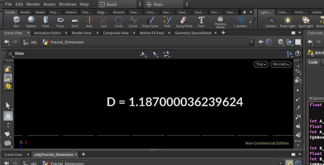

I'm trying round off to third decimal places.
The operation I did was
float target *= 1000;
target = floor(target);
target /= 1000;
but, the result was not what I expected.
ex 1.33000162266
If you know solution,could you tell me?

Joined: Oct. 2018
Hi,Everyone.
Thank you for comment.
I cannot explain my issue very well.
so, I attached my hip file.
As you can see, a target value is not rounded …
Anyone please help me.
Cant_floor.hipnc (70.3 KB)
9746 posts
Joined: July 2007
as mentioned previously, it's has to do with floating point precision
even if you do: f@target = 0.998;
you will see that the Font SOP will still print something else, like: 0.99800002574920654
it's because it can't represent 0.998 precisely as a floating point number
so you'll need to format your floating point number into a string using sprintf() for example
Cant_floor_fix.hipnc (71.1 KB)
