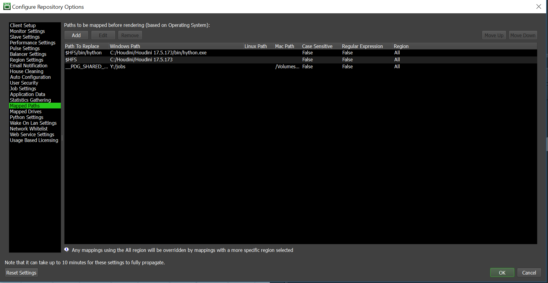

You'll need to set $HFS in Deadline's Configure Repository Options. It should point to your Houdini installation on the farm machines. The error was due to Deadline not finding $HFS and therefore concatenating with the default Deadline job path.
See screenshot.
See screenshot.
Alternatively, you can also just add a HFS variable in your scene. It should also be pointing to the Houdini path the farm machines have access to. Our custom launcher set that variable for us so it's a bit easier when you potentially have different production / daily builds installed.
Remember to transform any \ to /, not sure it's necessary anymore but it's often the root of some issues at some point

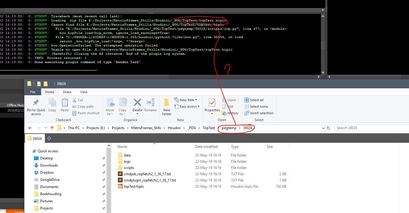

This is now with a single deadline scheduler.. but still no go:
Are you sure this is working at all? It's adding pdgtmp/{pid} to the filename location but it's not telling that to what ever is loading it later again:
ShellExecute=False Executable=C:/Program Files/Side Effects Software/Houdini 17.5.258/bin/hython.exe Arguments="E:/Projects/MatrixFrames_Stills/Houdini/_PDG/TopTest/pdgtemp/39028/scripts/rop.py" "-p" "E:/Projects/MatrixFrames_Stills/Houdini/_PDG/TopTest/topTest.hiplc" "-n" "/out/Redshift_ROP1" "-i" "ropfetch2_1_73" "-s" "GT:10841" "-fs" "1" "-fe" "1" "-fi" "1"
resulting in a:
2019-05-22 16:25:07: 0: STDOUT: Loading .hip file E:/Projects/MatrixFrames_Stills/Houdini/_PDG/TopTest/topTest.hiplc. 2019-05-22 16:25:07: 0: STDOUT: Cannot find file E:/Projects/MatrixFrames_Stills/Houdini/_PDG/TopTest/topTest.hiplc

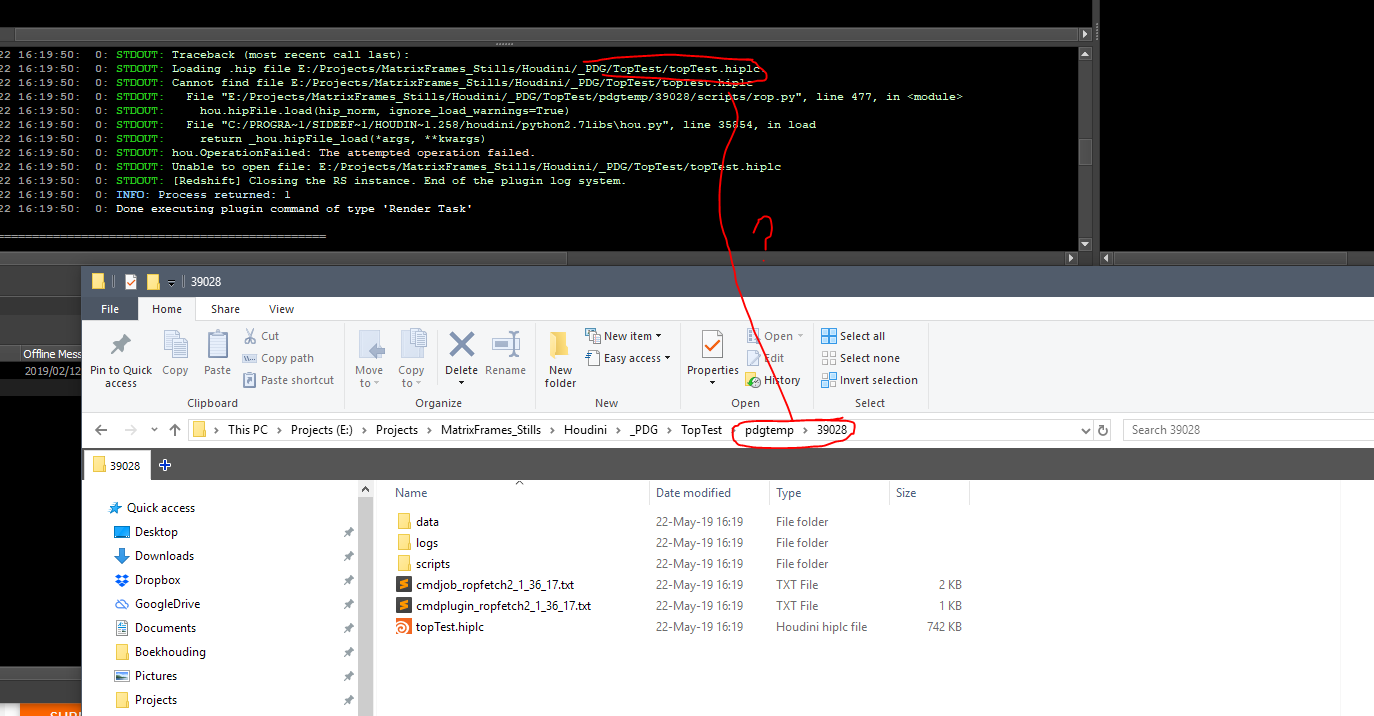

if I look at the task info.. the __PDG_DIR__ seems to be the problem here:

Joined: May 2017
The __PDG_DIR__ is your working directory, as set in Deadline TOP node. So looking at the screenshot above, it should be “EProjects/MatrixFrames_Stills/Houdini/_PDG/TopTest/pdgtemp” because it is the concatenation of your Local Root Path (EProjects/MatrixFrames_Stills/Houdini/_PDG) and Relative Job Directory (TopTest/pdgtemp). So there shouldn't be a PID in the file path. Can you reload your hip file in Houdini and try again?

Tried with a fresh scene.. I think it worked once but haven't been able to repeat that. It always stores stuff in a /pdgtmp/pid structure even when there is only a deadline scheduler present.
I've checked the pyhton code for the deadline scheduler, there is not even a os.getpid() in there so my guess is something is calling an invisible local scheduler that messes things up. Anyways, I've spend most of the day trying to make this work and I'd say it's broken.

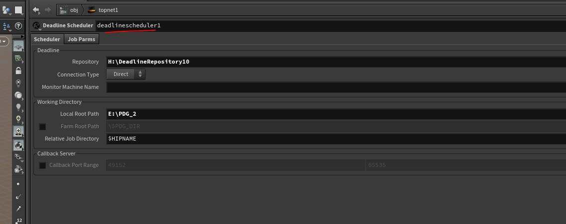

571 posts
Joined: May 2017
I tried your hip file, and it works fine, but had to make changes to the deadline scheduler paths to my local setup. I noticed though that you still have the local scheduler set as your TOP network's Default TOP Scheduler. Make sure you change that to the Deadline node, then reload the hip file.
Note that the PID is used internally to store intermediate PDG files such as scripts and logs, but that shouldn't affect your ROPFetch. But please double check that the ROPFetch is NOT specifying an External HIP file path.
Are you overriding the job parameters under the Scheduler's tab on the ROPFetch node? Post screenshot of it if you are.
More importantly, can you post screenshots of your Deadline node's parm values for both Scheduler and Job Parms?

Thanks for checking but still no go here… I've restarted various times, wiped everything.. double checked everything. No overriding job parms, no mapped paths in deadline. No local schuduler in sight and it really keeps putting things in /pdgtmp/pid so when I find some time today I'll dive into the relevant python bits and see if I can find the problem.
screenshots:
