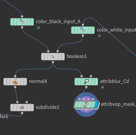

I just tried again the unified noise method to displace the mesh
But at this time i set an attribute with normals from the smoothed mesh (shot attached)
Maybe You explained something like this, but now it works
So basically that is the dark magic i didn't understand about mountain. It gets the normal from the smoothed mesh, and positions from the “proper shaped” mesh.
Basically now i have a mountain node in vex builder with much more control then just use a mountain node (of course without expressions)
One thing i don't understand. Now i got some hard edges, and i don't know how can i get “full smooth” in vex builder.
In worse case i can put a normal node after my attribvop, but would be good to keep everything (or as many as possible) in one node.
And again, i desperately need a “blur like” effect in vox builder.
It is extra annoying to always define a mask with bind export (i'm doing that because i don't want to use Cd all the time, and it can be also confusing what am i working with) and put an attribblur and then just to check my blur effect i have to create another attribvop and get a bind and connect it to Cd
It has to be some kind of averaging or i don't know what that blurs my float mask in vex builder
