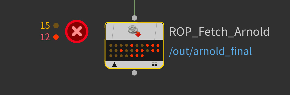

I would like to render sequences and wedges with Arnold using PDG/TOP.
My current setup uses a ROP Fetch node that points to the out/arnold node. I plug-in the rest of my TOP network (wedges, …) as input to that ROP Fetch node.
This renders the correct sequence of images, although the shaders are missing (my geometry is all pink).
I am using Arnold's Standard Surface Shader in SHOP, which I assign to my geometry.
I read online that SHOP was deprecated but can't figure out how to define an Arnold shader without SHOP.
Any suggestions? Is there another way to render with Arnold using PDG than using a ROP Fetch node?

It looks like i ran in the very same issue. Is this actually an issue? I made a simple testscene with a wedge, a ropgeometry and a ropfetch. The material is set by a material node right in the geo-node. THe shader lives in “shop/arnold_vopnet1” The arnold rop is rendering fine by itself but if the render is triggered by the ropfetch the shaders get lost. The wedge is working fine though. I don't seam to find an answer in the arnold forum either. Any direction towards a solution is very much appreciated.

Same problem happening here, just installed htoa and any scene with an arnold shader in it prevents PDG from launching instances. It's like hython doesn't see the arnold plugin or something. Is there a separate environment file for hython somewhere that needs to have the plugin path added to it?
Edit: I should add that this happens whether an arnold ROP is being called or not -- any kind of ropfetch or other TOP that spawns hython instances breaks with the errors below, if an arnold shader is present in the scene:
File "C:/PROGRA~1/SIDEEF~1/HOUDIN~1.563/houdini/python2.7libs\hou.py", line 48581, in load return _hou.hipFile_load(self, file_name, suppress_save_prompt, ignore_load_warnings) OperationFailed: The attempted operation failed. Error loading: C:/path/to/file/untitled.hip Warning: Bad node type found: arnold::standard_surface in /mat/arnold_materialbuilder1. Error: Unknown operator on load "standard_surface1.def". Unknown operator on load "standard_surface1.parm". Unknown operator on load "standard_surface1.userdata".
