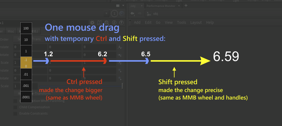

Thank you very much for your answers. In Houdini, the Shift and Ctrl are used in different ways:
A) MMB wheel on a numerical parameter:
- Shift scroll: makes the change 10 times smaller (precise)
- Ctrl scroll: makes the change 10 times bigger
B) Dragging the handles in the viewport:
- Shift drag: makes the change 10 times smaller (precise)
- Ctrl drag: constraints the change
C) MMB Ladder:
- Shift drag: unconstraints the multiplier
- Ctrl drag: unused
Personally, I like A and B. My dream would be to have this behaviour, as in the picture
It would make the desired changes fast, and also Shift (for precise) and MMB Ctrl (for 10x) will be consistent with MMB wheel and handles.
Edited by ikoon - Oct. 24, 2019 09:40:05
ladder ctrl shift.PNG (60.2 KB)
