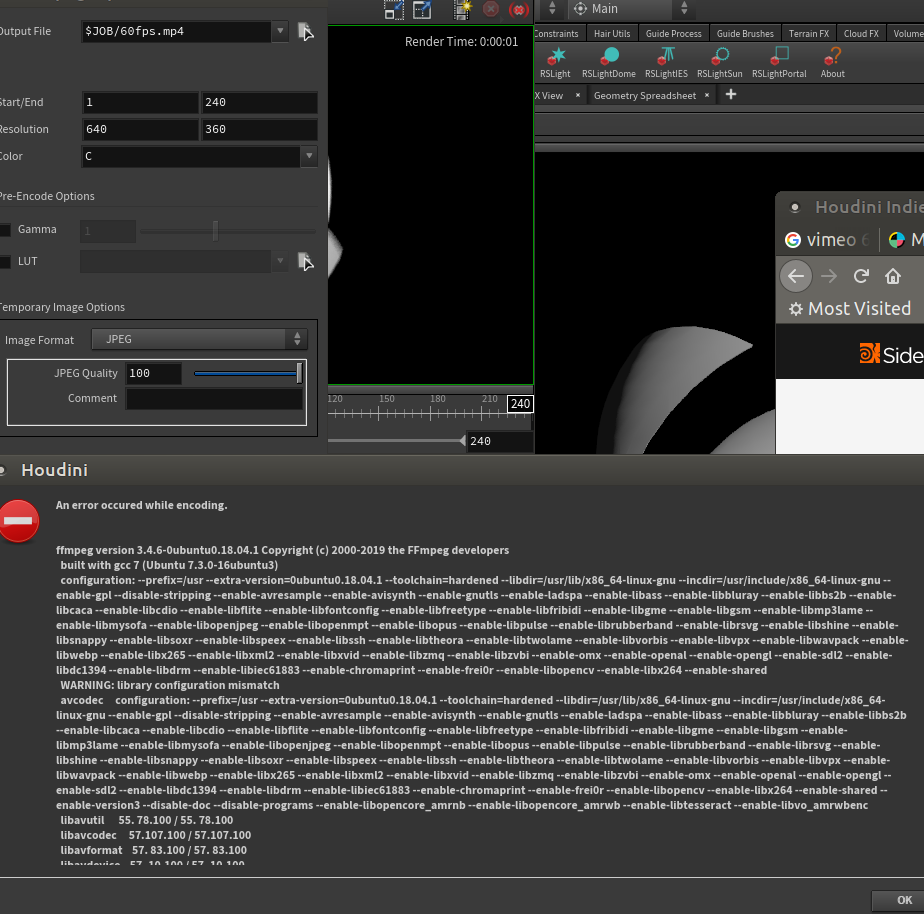

Not sure if this is a bug or I am doing something wrong so decided to ask here.
When I try and export a MPlay sequence to .mp4 file I am unable to use the $JOB parameter.
I get the lengthy encoding error attached below. If I simply change $JOB to $HIP it works.
Anyone know why?
ffmpeg Output File error from Mplay with $JOB

Hello i have the same problem here if you have installed fffmpeg by the unbutu app store is this why that doesnt work
try this for me now is ok
https://linuxize.com/post/how-to-install-ffmpeg-on-ubuntu-18-04/ [linuxize.com]
Sorry for my english but i learn too ^^

Hi there,
I use Fedora 35,
I have the same problem, I installed mencoder :
https://www.systutorials.com/mplayer-on-fedora/ [www.systutorials.com]
try to reboot after install,
and there will be mencoder codec option on the Mplay export lists.
Cheers.
I use Fedora 35,
Cheers.
