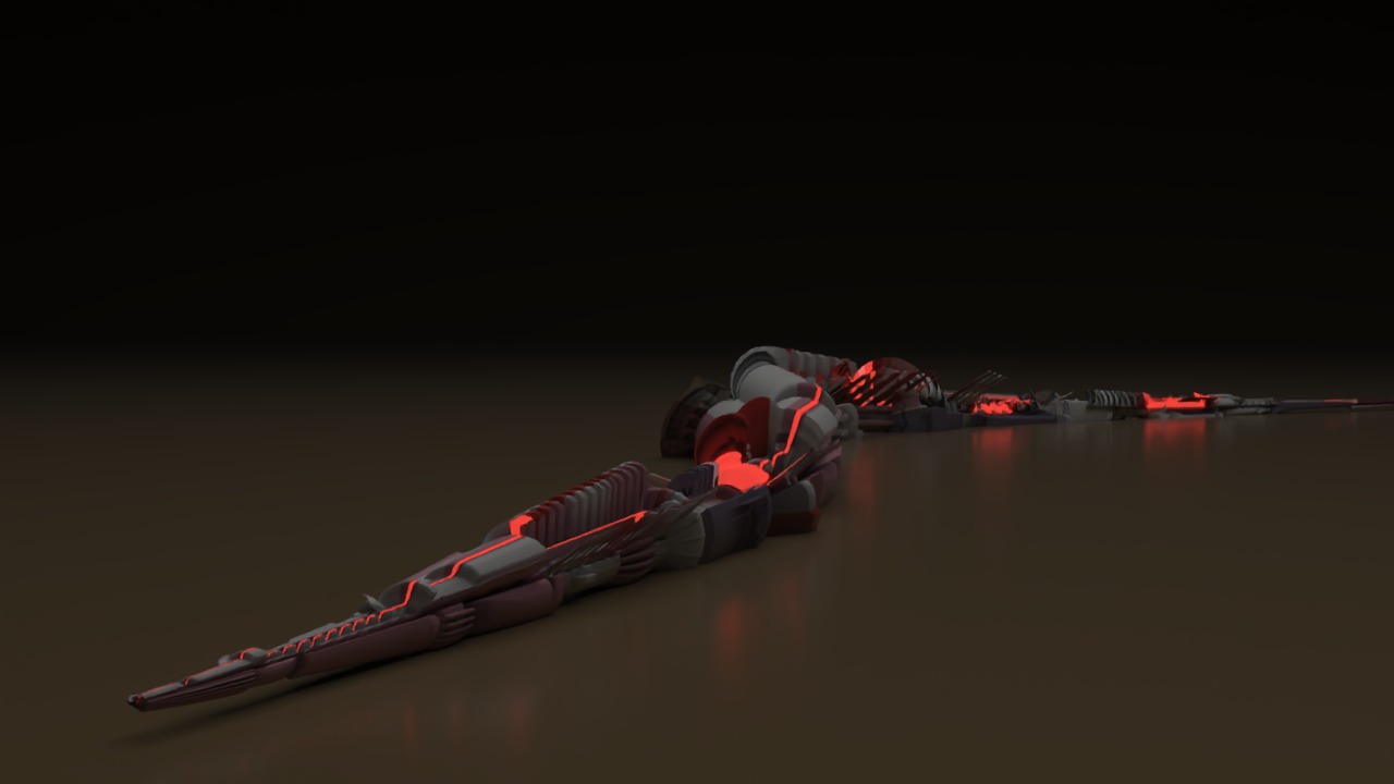

Ok, it looks like there is a bug with data flowing through the mtlxswitch using H19.0.591. Shouldn't the fallback data, and thus an attribute value flow through the switch?
In this material setup, I've set the color of input 1 to black, for specifying areas where emission should not occur. With the broken data flow, I bet I'm always getting a zero routed to emission. This doesn't happen in CPU mode.
I only want certain parts of the mesh to be emissive. Here's the CPU render.
Here is the XPU render.
Edited by Enivob - April 16, 2022 16:29:52

I usually use the native mtlx versions of the texture and primvar nodes instead of the usd preview ones. The fallback value is working with the geompropvalue node for me. Although changing to the default fallback value seems to fail to update. The attribute value is working either way.
600 posts
Joined: May 2019
The MaterialX "mtlxUsdPrimvarReader" definition appears to have a bug in it (ie not recognizing the fallback value at all).
I'll pass on the issue to the MaterialX guys.
In the meantime try using the regular "UsdPrimvarReader" instead.
Regarding "Switch" not updating when going back to default, that seems a bug in our UI and I've reported it.
