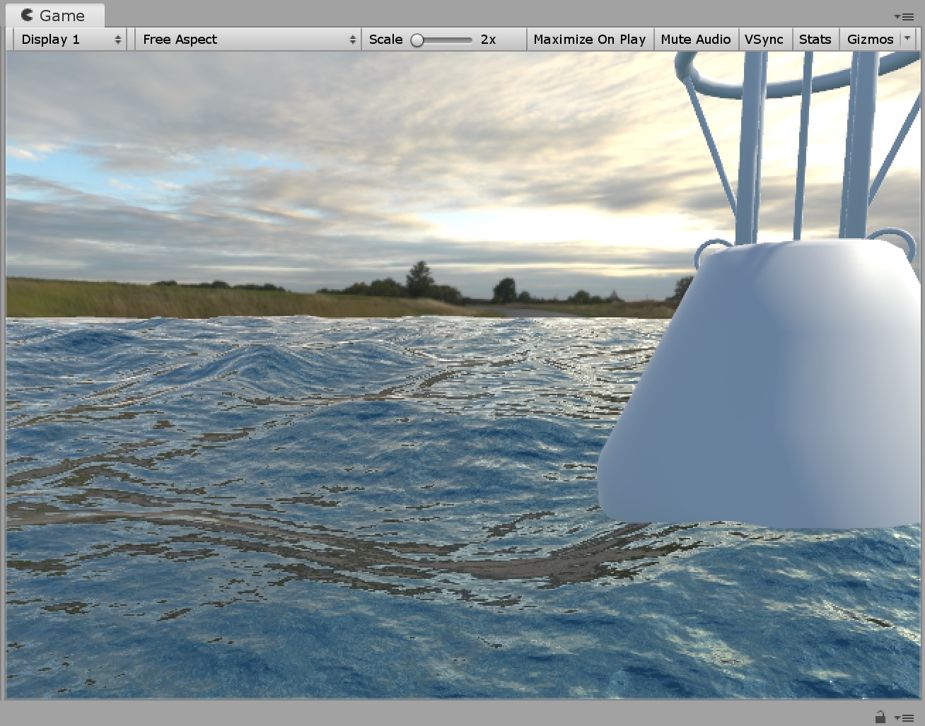

For the current state: I gave up on VAT (for this particular case)/simulating FLIP and instead opted to just bake an alembic simulation. This is what it looks like right now in Unity. I think it is ok, but will definitly check out the linked video because it looks like the better and more fitting approach.
Essentially I created a big highres circle, did a polyreduce that keeps the polys near the camera and smoothly transitions to lower resolution on the edges. This gets displaced by the ocean specturm-SOPs and looped by the game-dev make-loop-SOP (which is super useful). In Unity I made a shader in shader graph that uses normal maps to create ripples on the alembic animation.
Since I dont use FLIP anymore the buoy is “simulated” by a crappy self-coded solver for now. I guess it will stay self-coded but should be less crappy next iteration.
