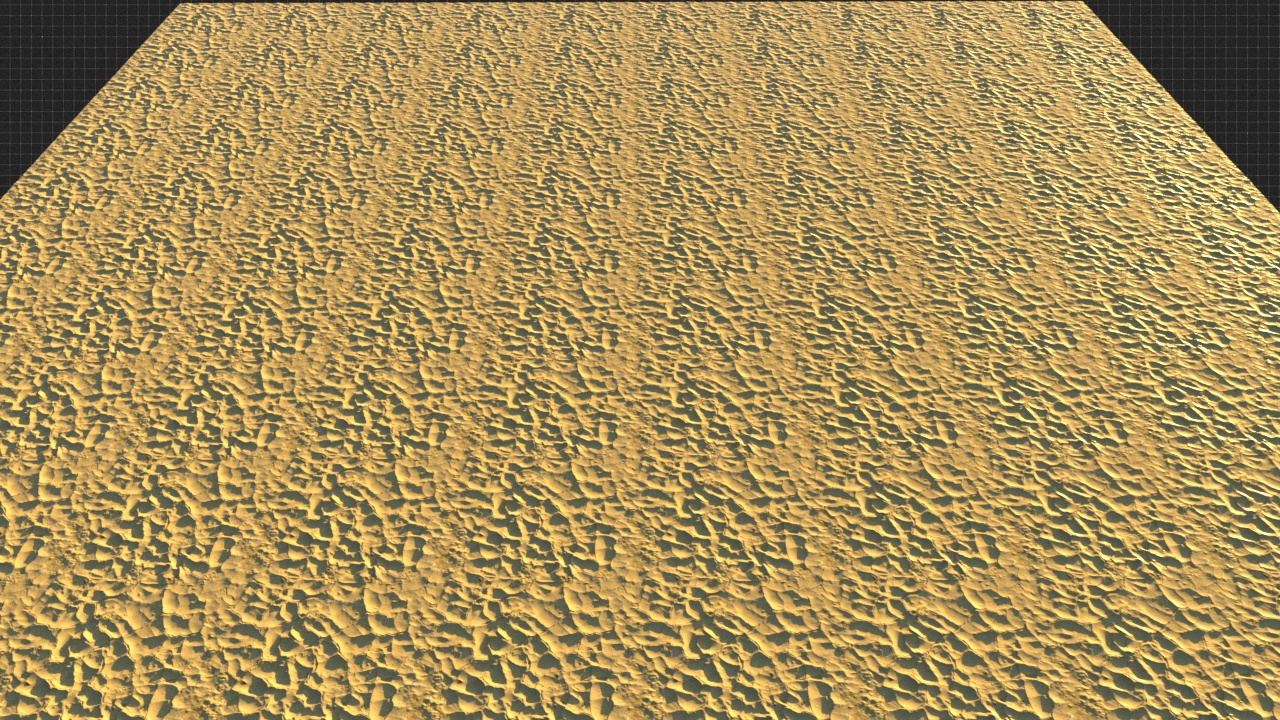

Yes, I was surprised how popular is the tile removal feature of the texture. For the curious, here is the options shown in the dlTextureNode:
Edited by aghiles - Feb. 17, 2020 12:52:27
