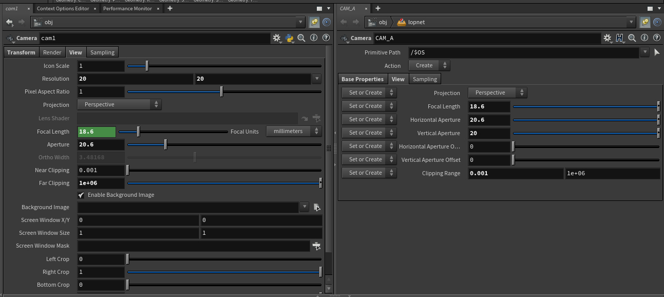

I've come accross a potential rfe which I'm not sure would really be usefull or desired, except maybe in specific cases.
In my case I was playing around with lighting and materials in LOPs, at a certain ‘stage’(non usd meaning) of my project.
But for additional objects and their layout, it's preferred to work at the obj level to get the new elements where I want them.
The issue is that I want to use the same camera settings I had in LOPs (how the image is ‘framed’), to be the same at the obj level.
With the LOP camera one can re-use the same parameter values of ‘perspective’ and ‘focal length’. But that's where the similarities end.
LOPs cameras have Horizontal Aperature and Vertical Aperature. OBJ cameras have resolution and a single aperature value.
One can't really map the LOP Aperature settings to the OBJ resolution because the OBJ resolutions are only in whole integer values.
Plus, even if they were floats, the question would be - What LOP aperature to use? Horizontal or Vertical? or some interpolated value?
Seems like it's not possible.
The short answer I guess would be - if one is going to render through Solaris/LOPs, just do the layout there.
Would be good to be able to have some option of direct camera mapping between the two contexts so one could work in either context and still get the same ‘framed’ results for the final render.
Solaris Camera to Obj Camera: Getting same view

I don't understand. The translation is relatively trivial. There are even nodes for converting one to the other.
LOPs to OBJ:
Aperture = Horizontal Aperture
ResY = ResX * Vertical Aperture ÷ Horizontal Aperture
OBJ to LOPs
Horizontal Aperture = Aperture
Vertical Aperture = Horizontal Aperture * ResY ÷ ResX
LOPs to OBJ:
OBJ to LOPs

Thanks jsmack.
Yes the application of what you've given is trivial.
Could be done slightly differently - for LOPs to OBJ:
Just use the corresponding Horizontal Aperature mapped to Resolution X, and Vertical Aperature mapped to Resolution Y
Then which ever one is the larger of Horizontal/Vertical Aperatures, use that value for the OBJ Aperature.
However, understanding how to get this to begin with is not trivial - other than trial and error to get an understanding of the relationship between the aperature parameters (either LOPs or OBJ).
Coming from a photography background, aperature settings in Houdini have no correspondance to what happens when you adjust aperature on a real camera - this is what confuses me and makes it hard to understand at face value what the parameter really represents.( aperature in OBJ or horizontal/vertical aperature in LOPs).
But again, thanks for the tip in giving me a working framework to go from.

BabaJ
The term aperture is a cinema term, it refers to the size of the metal window in front of the film. Changing the size of the aperture is the same as changing the film format. The ‘fstop’ as it's called in houdini refers to the lens aperture which is maybe what you are thinking of.
BabaJ
I suppose you could do that, but then the resolution of the render will probably be very very small and also most likely truncate your precision resulting in a different aspect ratio. I would use a real resolution, such as hd or a resolution corresponding to the plates, if any, and select a real film back size (aperture) from a physical camera.
BabaJ
Edit: What are these nodes you speak of? That do the conversion of one camera to another(if that's what you meant).
Scene Import (Cameras) (obj -> lop)
LOP Import Camera (lop -> obj)

Thanks for the tip on the nodes. The LOP Import Camera node works well.
